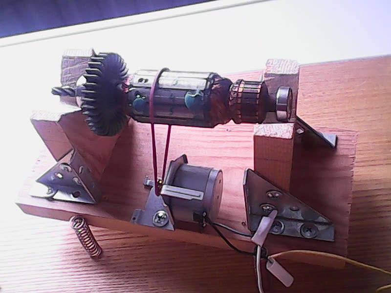

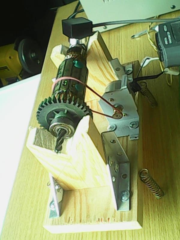

To speed up the measurement process, I advise you to make a simple balancing stand, which consists of a platform on spring vibration isolators and a simple measuring system.
Photos can be seen here :
Here is one of my acquaintances for a couple of hours made a stand from improvised materials for balancing motor anchors ...
you can laugh at him, but it allows you to balance anchors with an accuracy of 0.1 mm per second or specific unbalance of 0.3 grams / millimeter.
It's an interesting setup. Soft balance machine. If the mass supported on springs creates a resonant frequency far below balancing speed, then the spring force becomes negligible compared to mass acceleration forces. In that case we can write M*e = (m*r) where M is total mass (rotor mass PLUS the mass of other parts mounted on those springs like the wood, the drive motor etc), e is measured displacement of the moving mass, and (m*r) is the residual unbalance given as mass times radius (typically units of inch ounces).
0.1 mm/sec under some idealized assumptions means ISO G 0.1 (10 times lower residual unbalance than ISO G1.0).
I'm not familiar with units g/mm. But often residual unbalance limits are given in units of mass times radius, so maybe you meant 0.3 g*mm (?)
...converting that to more familiar units would be about 0.3g*mm * (ounce/30g) * (inch/25.4mm) ~ 0.0004 inch*ounce (!)
IF I am interpreting that correctly, that residual unbalance doesn't make any sense in terms of a goal worth pursuing nor a goal which is achievable on most industrial balancers, much less a homemade balancer....

I don't know exactly what is meant by "anchor"... a winch motor rotor? How fast does it spin?
Of course g*mm, thank you.
By motor anchor, I mean the rotor.
For the balancing process, a portable balancer Balanset-1A was used. You rightly noted that the correctly chosen rotation speed plays a significant role in such a setup. To ensure the sensors' sensitivity is adequate, a high rotation speed is required. Unfortunately, I don't have data on the rotation frequency in this specific example.
