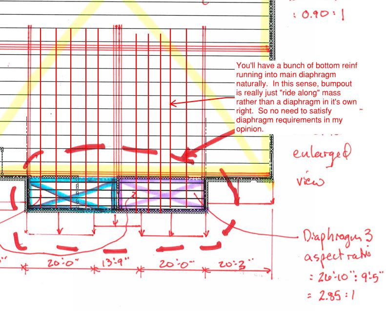

I am designing a middle school gymnasium storm shelter using 6" total thickness non-composite concrete slab over 1.5" form deck. I've read through the diaphragm sections of ACI 318 and saw the 3:1 aspect ratio requirement for considering the diaphragm rigid. For simplicity sake, I would like to analyze the full shelter as rigid in order to avoid putting together a computer model. With this being a storm shelter in a school, the Calculation Review process is pretty involved so I want to make sure that I have code backing for my analysis.
In the attached pdf, I've shown with highlighter what I'm considering my separate diaphragms for loading in each direction. In order to meet the 3:1 aspect ratio, I've broken the southern 9'-5" x 53'-9" bumpout as two separate diaphragms with each meeting the 3:1 aspect ratio requirement. So the question is, is this an acceptable way of analyzing my scenario? Is there any reason that I can't break the lower section into two separate rigid diaphragms as shown?
I am still getting familiar with the full code provisions for rigid vs semi-rigid so please feel free to point out anything that you think would be of value.
