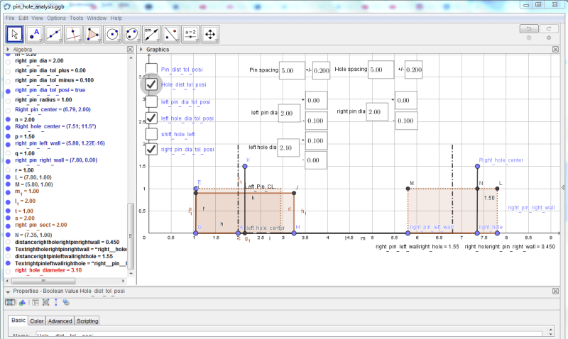

The answer to your question depends on what "minimum diameter" means. The following should allow you to work with whatever definition you like.
I have a GeoGebra file attached that lets you work with this problem. I have scaled the majority of the dimensions down by a factor of 10 and reduced the spacing to better fit on the sheet.
The check boxes select the various conditions:
1) Sets the pin distance position tolerance to positive, else it is negative
2) Sets the hole distance position tolerance to positive, else it is negative
3) Sets the left pin diameter size to use the positive tolerance, else it is set to the negative one
4) Sets the left hole diameter size to use the positive tolerance, else it is set to the negative one
5) Sets the calculation as if the left hole is pushed to the left against the pin, else it is pushed to the right
6) Set the right pin diameter size to use the positive tolerance, else it uses the negative one
At the bottom of the list is the expected hole diameter for the right end hole.
GeoGebra is available for free from The file I created is from GeoGebra Classic 5 for Windows. See for Classic 5 and Classic 6.
It looks like:
The right side hole diameter is marked in red.
If a change is made that breaks the diagram then just reload from the one I posted. For no reason it sometimes evaluates the results as true/false rather than numbers. Maybe they fixed it in Classic 6. Anyway it's free, so you get what you paid for, a bargain at twice the price.
