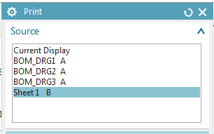

I found the below code for batch printing.
The only problem seems to be that it will only plot everything on 11x17 as it is set to Tabloid. Which is good for all of our drawings except for the BOM sheets. We print our BOMs on 8.5 x 11.
Worst case scenario is we toss a few sheets out each time we batch print. If possible I would rather change it to one of two options. If one of the following options is not too difficult of a change, could someone please fix this?
1) It would automatically change and print the BOMs on the letter size paper.
If that cant be done too easily, then possibly this...
2) It skips the BOMs in the printing process entirely. It is possible to have a dozen or more Bom sheets in a file, though its rare.

Try the code below; we'll need to adjust it if you use custom sheet sizes in NX. Might also need to adjust the orientation for the BOM sheets. I uncommented the code that reports the drawing sheet size and part name; once the code is tweaked to your preferences, those lines can be commented out.
Code:

Thanks cowski
I am getting a small error that by now I should know how to fix because I have seen it so much in the past. lol This is how little I have taught myself. lol
Lines 35 and 50 are getting errors saying "ChangeDisplayPart" is not declared.
I tried just commenting those two lines out as I couldnt seem to connect them with anything else. It gave me an original error but I ddint see what lines. I couldnt find the small window box with the errors listed. So I ran it a second time and it didnt give me any error that time.
It ran prints of the right sheets on the right size. However, it only ran the prints from the work part.
The original code cycled through all open parts (or all parts in the navigator or something) and printed off any drawing sheets it found in components.
Which I am guessing is why it needs those lines I commented out? lol
OK
I uncommented those lines so it changed display to other components.
I got an error on line 100 and 43 then. I noticed in the original code I had to comment out line 100 to get it to run. So I commented that line out again.
It ran all of the details and did the job exactly as I wanted. Awesome.
The only problem I found is I had some blank sheets printed out first. However, I have no idea if I printed those or someone else. lol So I will need to test that as I had it happen once earlier too.
I have no idea why I had to comment out line 100 to get it to work. But it worked. lol
So I am guessing I can just compare it to the previous code to comment out the LW lines so it doesnt write to the info window amd I am set.
Thankyou very much cowski.

When copying and pasting, I accidentally deleted the "ChangeDisplayPart" subroutine. Sorry about that; glad to see you figured it out and put it back in.

(SIGH) Just a warning to anyone who sees this. There are 2 major problems with this code.
1) As already mentioned, it prints blank pages from any component opened that has an empty drafting sheet. Which in our case, I am learning are quite a few of the purchased components.
2) It seems to be printing any drawings that are even open. Not just the details connected to the main tool you have on display. So if I worked on a main tool with several units earlier but switched over to a small pin unit for a different tool and printed that, it would print that small pin tool and its components and the large tool I still have opened and all of its units and details. lol A lot of wasted paper if you arent careful.
Try this version, it should skip blank sheets.
The code (as the original) works on all open parts. If you want to limit the scope to certain parts, more work will be required.
