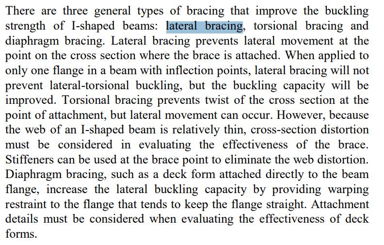

The following text is from "Buckling of Beams with Inflection Points" by Yura.
In the statement, " Lateral bracing prevents lateral movement at the point on the cross section where the brace is attached. When applied to only one flange in a beam with inflection points, lateral bracing will not prevent lateral-torsional buckling, but the buckling capacity will be improved."
Does this mean in beams WIHTOUT inflection points, the lateral brace WILL prevent LTB?
AISC Section 6.3 allows for the use of lateral bracing, but based on the appendix statement above, this lateral bracing does not actually prevent twisting of the cross section.

"Does this mean in beams WIHTOUT inflection points, the lateral brace WILL prevent LTB?"
It better because that's how we design in Australia. And UK I guess because our rules probably came from them. The reason is because point of twisting is the bottom flange for s/s beams so top flange brace is enough to keep it all straight. On condition there's proper lateral and twist bracing each end. Which is why it doesn't work for cantilevers with tip just flapping around.

Bracing the top flange will prevent lateral deflection, but not twist. I believe is there is a full depth shear plate it will prevent twist. Not sure about partial depth. Especially if it does NOT connect to the top flange. Though I'd have to review references before I said this definitively. Also, if you have a diaphragm on the compression flange, then it will likely prevent twist as well.

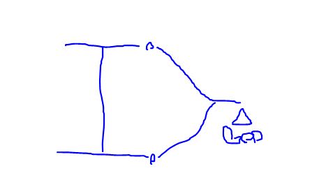

There's no such thing as lateral only buckling in this context. A purely lateral motion allows a vertical load to do no additional work. Ergo the load has not shed potential energy and buckling has not occurred.
AISC said:
Beam bracing must control twist of the section, but need not prevent lateral displacement.
What AISC is getting at, and doing a poor job of it, is referring to the bracing condition shown below where the beam can translate but not rotate. Because it can't rotate, the movement of the beam is constrained to pure lateral translation which, per the above, cannot constitute buckling. The most common case of this is where the LTB bracing is provided by an incoming roll beam that is, itself, not braced against lateral translation by a diaphragm etc.

Your quick detail should be pasted into the text of Appendix 6. I hope to see that exact sketch in the next edition.
I'll send a strongly worded email... as one does.
