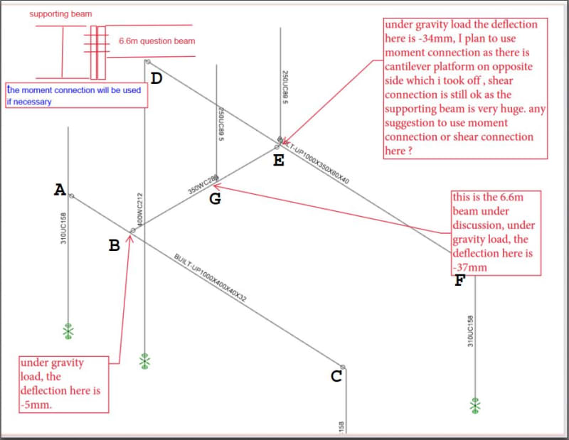

Hello All,
I am designing a 6.6m steel beam with 20mm displacement difference at the ends. this beam is supported by beams, one end is moment connection and the other end is shear connection. Is there anybody have suggestion regarding to how to consider the load resulting in the beam end relative displacement or know any document discussing about this topic?
Currently, i doubled the beam length to 13.2m and add 20mm displacement at the center of the beam to get the additional load, is there any risk or concern to use this method?
Thank you for your advice and time in advance.

I updated the 6.6m beam condition, it is supported by beam at both end, the supporting beam stiffness is different, so there is beam end relative displacement.
Thank you

3. I uploaded a sketch for the structure, it's only part of the whole frame. the supporting beam is strong, i can add horizontal support fore the supporting whatever i want, but can't no adjust the depth, i uploaded my sketch how to get additional load due to bean end vertical displacement as well.
 https://files.engineering.com/getfile.aspx?folder=ec5ed3e6-ad4b-4ebe-8cbc-5fae87d6e0e5&file=structure_sketches.pdf
I don't follow your 3 sketches at the end.
I'd suggest two shear connections, it makes the beam statically determinate and so the stiffness of the supports is irrelevant (this'll just change the magnitude of the deflections, and not change the loads.)
Not my field, but I don't like your moment connection (just attaching to the web ... looks like a shear connection). For me, a moment connection has good loadpath for the cap loads (the couple that is the beam moment at the end).
The sketch indicates that dB and dE (where d indicates deflection) = 5mm and 34mm respectively, a difference of 29mm, not 20.
Assuming a pin at B and roller at E, dG = (dB+dE)/2 + PL[sup]2[/sup]/48EI where L=6.6m, not 13.2m.
A moment at point E affects the simple span moment at G, but we don't know the value of that moment from the cantilever platform, so it can't be included at this time. Deflection in Beam B-E due to a moment at E is readily found using moment/area principles.
Hi BAretired,
i used factored deflection in the sketch, the factored deflection 29mm, the unfractured deflection is around 20mm.Sorry for the confusing.
I am trying to figure out is there any addiotnal load due to beam end displacement.

ArcherC,
End displacement does not cause any load in Beam B-G-E. It simply moves down as a rigid body, and deflects as a simple span (or in your case as a simple span with unknown moment at E).
If you want to take into account M[sub]E[/sub], we can review that. A moment at E does affect the reactions of Beam B-G-E, and also the deflection of the two supporting beams.

ArcherC said:
if they are shear connections on both end, the current design software as far as i know, they can't consider any additional load due to the beam relative displacement. There are not shear connections on both ends. At point B, you have a hinge. At point G, you have an applied moment from the cantilevered platform. The 6.6m beam has a rigid connection to the supporting beam, sufficient to resist the applied moment. The extension to the platform must also resist the same moment.
that's the reason why i have concern for the 6.6m beam. There is no additional load due to relative displacement, so there should be no concern for the 6.6m beam.
For bolted connection, normally bolt hole is 2mm bigger than the bolt, i think 5mm end vertical displacement difference can be ignored, but if the value is greater than this one, from software analysis result, there is no additional load, but in reality it will cause additional force on connection. No! In reality, it will not. Forget about the connection until you have analyzed the structure, then design the connections each side of the supporting beam, one to the 6.6m beam, the other to the extension which supports the platform.
I am trying to figure out or looking for any project experience or document can address this issues. It appears to be a simple structure. I see no problematic issues.

Hi ArcherC,
A simple beam with pin/roller support is deemed to have zero moment at each end. That is theoretically correct, provided the supports are true pin and roller. If one support drops 20mm, the end moments remain zero, because a pin can't resist moment.
It is true that we can't build a perfect pin joint (we do our best), but it is standard practice to assume zero moment at each so-called "pin" or "roller" as phamENG has mentioned.
If the small moment resulting from an imperfect pin is to be considered, then it should also be considered for the case where both supports remain fixed in height, because the slope at each end of the beam due to its load is usually greater than 20mm in 6,600mm.
