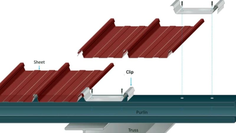

Hi All,
Please see the clips below, is it reasonable to assume that the roof sheeting spaning between points A and B can restrain the purlins thereby providing lateral restraint to the rafter compression flange? If true, are there any guides or empirical rules to check the stiffness and strength of the assembly?
Many thanks.
Yes and no. The roof sheets and purlins are strong and stiff enough to restrain the TOP flange. But who said that is the compression flange? The bottom flange which also can experience compression along its length likely needs to be restrain as well. In the case of the first picture that is covered by the fly braces.

I think the purlins are only restrained by the shear strength/stiffness of the roof sheeting spanning between points A and B, but in most cases, the connection between the purlins and the sheeting is very complex as shown below and not easy to quantify the stiffness.
Perhaps there may be a test done to quantify the shear stiffness of the whole assembly?
Never done calcs on this. In your first post, you asked for empirical rules. The empirical rule is purlins provide lateral restraint to the top flange for normal connections (not much clearance between flange and purlin). The tests are the thousands of buildings where this works. Potential problem is that roof sheeting sometimes ends up in the next suburb in a big storm. Another potential problem is that you'll be drummed out of your job if you worry about the first problem.

That is more generous than I would consider a purlin restraint. If you adopt this approach where is the need for fly braces? Also what are your hole tolerances? I'd hope they aren't slotted and oversized holes! I'm an AS user I'd not consider roof purlins as restraining the the bottom flange without fly bracing.
And it would seem that the document you linked agrees with me. The document suggests to avoid a fly brace you need stiffeners and non standard cleats and purlin holing.
You are overthinking things. But if you want to satisfy yourself then you'll have to do the hard yards yourself and make a few assumptions. You'll quickly find that the stiffness and strength of the purlin sheet is MORE than adequate. If you are stuck and unsure on the strength of the clip lock system then start by considerer a self driving screw system. I have no idea how strong the clip lock is but there would have been proprietary testing and there is a reason why there are generally wind limits on where it can be used.
