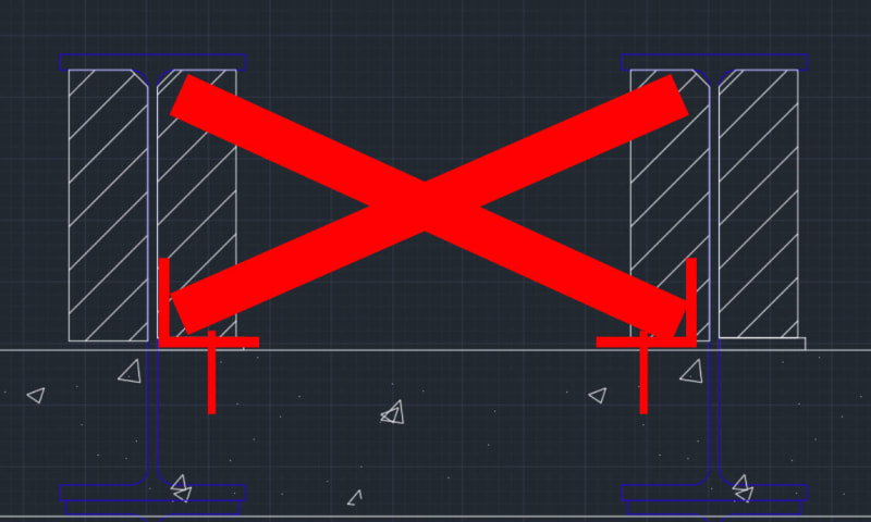

I have a job where a piece of rotating equipment is sitting on top of steel beams. Rotation is in plane with the length of the beam, so theoretically there is no (or very little) lateral force on the top flange. The beams were supposed to be set such that the slab was poured flush with the top of the beam, however, the GC instead poured the bottom of the slab level with the bottom of the beam tension flange. This created the situation shown in the photo below. Now we are getting a very slight oscillating lateral movement at the top of the beam (~.04"), which I have been asked to come up with a fix for. My initial thought was to chip out the slab in a few locations and weld full height stiffeners at load and bearing points, but the contractor asked if it could be done without chipping out and just weld stiffeners as shown below, either with or without the addtional bearing plate between the stiffener and the slab.
I have already checked global bending capacity is fine without the full lateral bracing of the compression flange, we just need to fix the lateral deflection issue. I'm not really sure what calcs to run here as I dont believe this is a case of web yielding or crippling. I used the deflection to calculate a max lateral force on the flange but now what?? Any help here is appreciated.

If you wanted to approximate the lateral deflection you're seeing, you could use roughly half of the weak axis moment of intertia and an assumed length of participating beam. To dial in the length of beam you could use your measured deflection.
All that above is strictly for a gut check if necessary.
Personally, I'd want the bearing plates for the stiffeners. Because in my mind, if there's still a portion of unstiffened flange between the top of concrete and underside of stiffener, you're still going to experience some flexibility. It will likely be an improved scenario without the bearing plate, but may exhibit movement.
I agree with using a bearing plate in combination with the stiffener plates.

@jayrod12 - I approximated deflecting force with delta = PL^3/3EI, as I am assuming the deflection is coming more from rotation of the web& top flange about the "fixed" end embedded in the slab. I came up with ~2250LB, but I really cant figure out where this is truly being generated as the rotation is in the same plane as the beam length. Good point regarding the bearing plate - this was my thought as well.

@xr250 - this is an interesting idea. I realize now that I left out any dimensions - this is a W18 with top flange ~12" above the slab. If this was larger, I think knee braces would work better but I'm not sure the added complexity is economical

Honestly, the knee braces are probably an easier fabrication option and be a more effective solution. They only need to be on one side of the beam. Welding the proposed stiffeners the underside of the top flange is going to be fun.
I assume there are a pair of these beams at least? What about just tying the tops of the beams together so they're resisting the lateral load in concert with each other.
Discrete web stiffeners (with or without the proposed bearing plate) will not increase torsional rigidity. If you want to prevent lateral movement, your best option is to weld web plates to one or both sides of the beam, and to connect these web plates to the beam web with horizontal plates at height of the concrete slab. By welding the horizontal plates first, you have more than enough space for welding the vertical plates. The required plate thickness will be small, and can be hand-calculated (bending, shear and torsion of the box).
The result is great torsional resistance (a double-cell box section, assuming direct bearing of the horizontal plates against the concrete slab) and great lateral inertia, which will prevent any lateral movement.
Like jayrod said, are there two beams, and if so, how far apart are they. I'd suggest more of a diaphragm bracing scheme. I.e., L3x3 x-brace between the beams at some interval along the beam. That also assumes there doesnt need to be an open space between the beams. Maybe even use some sort of baseplate where the bottom nodes of the x-brace / diaphragm bracing thing attaches to the beam web at the base. Probably overkill. But it sounds like a critical problem.
@centondollar - Im not sure I agree with your assessment that stiffeners + bearing plate wont solve this issue. Its not quite a torsion problem, but cantilever bending of the web plate

Agree with centondollar: web stiffeners will not change the torsional stiffness of the beam. I did a FEA study on this some years back.....and you have to add a impractical number of them to make a difference. I like the brace idea others have proposed.
@WARose - if the issue is from cantilever bending of the web plate as opposed to torsion - adding stiffeners solves this, correct?
It seems the web plates need to be added if I am to propose the x brace, so I may just have them add the stiffeners first and if there's still any movement, then add the bracing

I wrote that welding vertical and horizontal continuous plates to the section will increase torsional stiffness and lateral inertia. If you have "cantilever bending" as you describe, you are dealing with both warping torsion and weak-axis-bending - both of which are greatly reduced with the proposed solution.
Discrete stiffeners do not change the global behavior of the beam and will not prevent lateral or torsional deformation or vibration.
