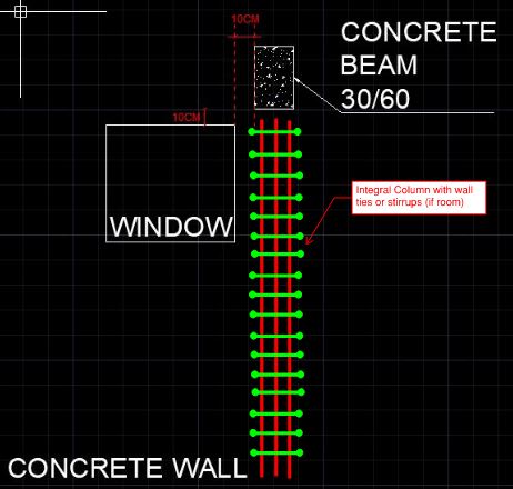

i have a design situation with a concrete wall , with a window opening, and a concrete beam that ends quite close to the window, about 10cm horizontally,
see diagram:
my concern is that the load from the beam going into the wall will cause cracks around the window area - as the load spread of 45 degrees hits the window area below it...
are my concerns founded? the beam end support reaction into the wall is about 50 tons,
