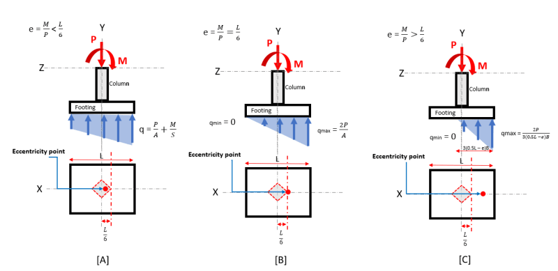

what is the correct formula for maximum pressure for a eccentrically loaded foundation subject to a large download and moment simultaneously? i see a lot of examples for one but not both.
see the attached example
Thanks a lot
Find the moment due to the eccentricity, add the applied moment, then divide by the axial load.
That will give you an effective eccentricity and you can use the standard formula.
For combined loads as shown the eccentricity will be outside the edge of the foundation, so it won't work without piles or some sort of anchor.

If your force is outside the kern, you will have tension. Your system, as shown, is incorrect and the load would have to be at the third point for that distribution assuming the moment is due to the eccentricity. With the moment shown, if in addition, the situation is worse.
There are several solutions to footings with eccentric loadings (wild ones even).
If the sum of additional eccentricity ( ead= M/P ) and ecc. of N is outside the footing area , the ftg will topple ..
Check your case for the following alternatives.. if e=M/P > (L/2) , the ftg will overturn ..

So, to clarify, the effective eccentricity, e is (N * e1 + M*)/(N+Wf) ?
e1 = dist of eccentricity to centre of footing (centre of wall to centre of footing)
wf = weight of footing
if e > b/6 then uplift

"if e > b/6 then uplift" not necessarily so, if the moment is in addition to the eccentricity.
That's easy to fix... just apply a load of +ve and -ve value at the location of where you want the load to be applied. the use the one at that location and add the moment caused by the force x the distance of the concentric load to the location of where you want the load... just remember to keep track of the sign of the moment... it may increase, or decrease the original applied moment. [pipe]
These three conditions are identical... showing translation of a point load to point 'a'.
Draw your free-body diagram. The resultant from the bearing stress needs to be equal and opposite to the applied force.
