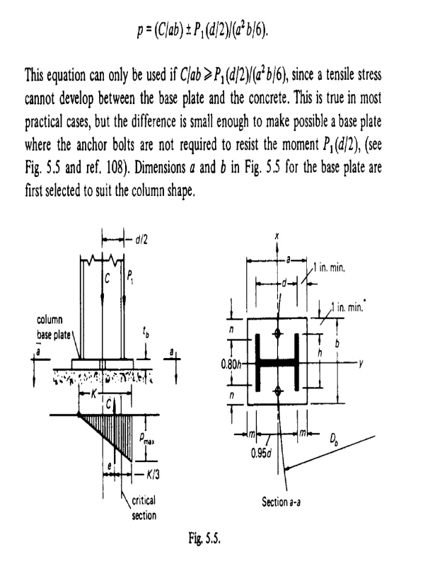

The problem is, in the design of the base plate, Page 149, he takes the moment on the bottom of the plate as only being due to the eccentricity- no Fx3/4L in that term.
So am I missing something here, or did Bednar blow it?
If you try to include that 3/4FL moment on the base plate bearing, then you just can't make the base plates big enough per his design procedure.
Yet, I can't see any reason to exclude that moment, either.

Yes, the overall moment as shown on in Fig. 5.4 is correct.
It is the moment in an individual leg, that is omitted in evaluating the base, that is the issue.
Note the moment contribution from 3/4FL in the equation for fb on Page 147- which is omitted in Fig. 5.5.
F(3L/4) is only for the column (shape), not for base plate
P1 is used for base plate calculations. Base plate not depends of L

That's exactly my point- his moment immediately above the base plate includes F(3L/4), while his moment immediately below the base plate does not- but should- where did that moment go?
And note this is 3/4 of the moment that prevents the legs from folding over at the base- it's not negligible or trivial.
Mr . JStephen (Mechanical)(OP) I looked to the same page and copied and pasted below ;
You are wright ..moreover, the term (C ) is equal to P1 for the leeward column.
the bearing stress formula for the leeward column base shall be ;
p= C1/(a*b) +,- ( M1/ W ) Where, W= section modulus for the base, W=(a**2)*b/6
C1= (W0/N)+ 4Ma /(N*D)
M1= F1*L*3/4
F1= P*I1/( Σ I)
the bearing stress formula for the windward column base will be ;
p= C2/(a*b)+,- ( M2/ W )
C2= (W0/N) - 4Ma /(N*D) and M2 = F 2 *L*3/4 In case of equal sections (which is common), F1= F2
I would agree, it doesn't seem correct, if C is the compressive reaction then the diagram should be corrected. The eccentric loading caused by P1 is more relevant to the buckling assessment. The moment generated by P1 is opposing the moment at the base plate, caused by the lateral load F, so I would exclude it and design for the base plate moment M (which should be higher). If you are treating the base plate as a moment connection then it has to be capable of transmitting the equivalent loads to the footing, typically this would required anchor bolts outside the flanges, not covered by this method which is pin connected. So the inequality that would need to be satisfied should be based on the leg moment M at the base plate. You could have some uplift provided the bolt doesn't see prying loads, otherwise design as a moment connection. I also see an issue for bearing loads on saddle supports in Moss (Bednar isn't any better), the maximum bending component is added to the vertical load and averaged over the full base plate area to get the bearing pressure, but the bearing pressure over part of the base plate will be higher and would require a thicker base plate if calculated accordingly.
The amendment by HTURKAK is conservative, since the bearing pressure is calculated based on the peak moment. You could get suitable result by averaging over the area that is actually in compression from the moment or using a 1/3 type distribution (similar to the figure posted above).

The bigger issue to me is that the method can only be used if base plate bearing pressure calculates positive all across per his comment, but if you apply the design leg moment, that is almost never the case.
Consider that vessel design with legs support is good when wind /seismic is low. Otherwise a skirt is required.
Regards
Essentially, you would only ever used the pinned base plate with braced legs. Without bracing always use a moment connection, but this would only be applicable for relatively moderate loads or the design will be far too inefficient. It is a bad example to include and should not be used as a design guide.
