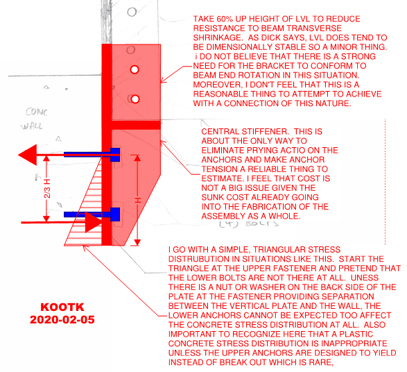

1) I like your idea of putting a gusset underneath the seat in which case I see no need for checking the plate above, or the LVL bolts, for bending/moment. Otherwise, I do think that you need to check the vertical plate for bending. [phi x Fy x Zx]
2) In conventional situations, I would avoid trying to transfer moment into the LVL via the bolts. The constructability detailing in these situations, which allows for tolerance in LVL bolt hole locations, usually results in horizontally slotted bolt holes in the steel side plates which would neuter moment transfer.
3) Give some consideration to the moment delivered to the concrete bolted connection as well of course.

Vrapps, to resolve the moment, you can consider the moment couple across your concrete bolt/anchor/stud spacing. This will be conservative, but is sometimes still gives reasonable results (depending on loading and geometry, type of anchor, etc).
Alternatively, you can take a more refined approach that considers the bottom of the steel plate bearing laterally on the concrete, which gives you a longer moment arm (and potentially all four bolts contributing in tension, although the top two will take more). Similar to a reinforced concrete beam compression in bending, with a compression block and 4 "reinforcing bars) in a cross section.

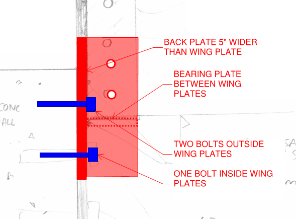

Another option if there's space and you're looking for something a little more compact and less fancy.
Thank you all guys, it gave good insight. Appreciate your time!
Kootk, I like your last detail (the less fancy one) it is very ideal!

Lomarandil said:
To tease this out a little, I'm not so sure that the stress distribution you (KootK) show is inherently superior to a distribution concentrated at the bottom of the plate. (Except maybe in efficiency of design effort).
"Superior" is a bit strong for my liking but the distribution that I proposed does have three advantages:
1) it's computational expediency as you mentioned.
2) it's likely to be conservative in a situation where the accurate assessment of the stress distribution is problematic.
3) it does not suggest a plastic stress distribution predicated upon the ability of the anchors to yield plastically before initiating concrete breakout.
If my method produces results that I feel are impractical, I will consider more agressive stress distributions
Lomarandil said:
This gap means that as the plate pivots about the top bolt, the bottom edge bears first.
It seems to me that all of your gap sources could just as easily produce a first contact point anywhere up the height of the plate and, therefore, the system might not pivot about the top bolt and may well exacerbate potential prying issues. This is a bit of a slippery slope rationally.
My expectation is that the substrate would be flat enough that:
4) Smallish surface imperfections would crush and redistribute stress.
5) Plate deformations would help to redistribute stress.
It's tough to design a thing without relying upon the quality of that thing to an extent. If the wall face looks like the Rockies viewed from 10,000 ft, them I'd want some grout between the plate and the wall.
Lomarandil said:
...or at least a "masonry-style" triangular block that doesn't necessarily reach the top bolt...
Sure. But then any stress distribution with a neutral axis lower than the top bolts implies meaningful strain in the upper anchors which have a very short stretch length and, usually, a brittle governing failure mode. The use of the rectangular and masonry triangular stress blocks is common and shows up in the literature. It's simply not my first choice for lightly loaded things for the reasons that I've mentioned.

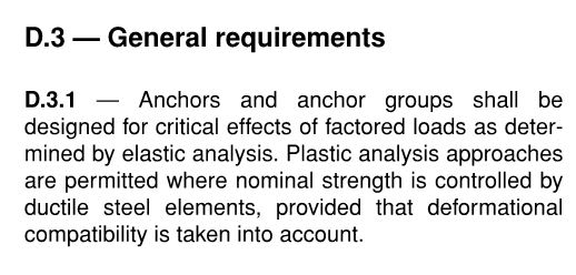

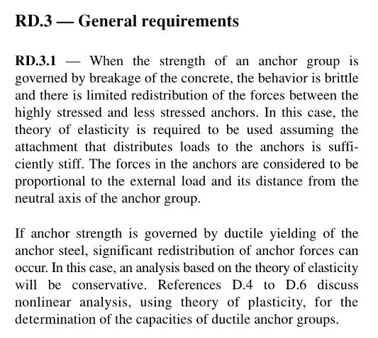

This kind of thing. Although they always seem to be more concerned with the anchor tension forces than the concrete compression forces.
