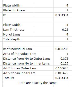

Here's an odd puzzle I've encountered. I must be missing something, as the calcs do not match 'common sense' (IMO).
I am reviewing bending of a flat steel bar about the weak axis. Very straight forward to determine I, y and then S.
If I compare using multiple, thin flat bars (same width that add up to the same thickness), the value for the composite I and S are 4 times _greater_ than the single thick bar. This was computed using parallel axis theorem [I= Σ(Io + A·d²]. The thin plates are adequately connected to resist sliding or separating.
A bit of surfing the web results in a lot of composite material topics, and CLPT (classical laminated plate theory). Therein, examples and discussions seem to point to reduced deflection for laminated plates being about 25% of the equivalent sold plate. This matches my calcs suggesting a 4x increase in mom't of inertia.
The underlying assumption for this case, in CLPT and in PAT is the layers don't slip past each other. The proposed stack is stitch fastened, so layers don't slip.
This increase in section modulus is just not logical to me. The stacked bars should be weaker than the equivalent solid bar. If not, we'd be making durn near every thick flange steel beam out of stacks of thinner plates.
Thanks for your help and guidance on this puzzling observation.
You must be doing something wrong.
The calculations should give exactly the same result.
Can you give some example references showing 25% deflection for laminated plates?

I get exactly the same for solid vs. a 4 Lam plate:
faq731-376
here is what I get for a solid 12x6 and then the same broken into 2 unit layers:

Raf,
Are you saying for example you have a single 4" wide x 1" tall bar. Then you have four bars that are 4" wide and 1/4" tall that create the same size shape as the single 4x1? The 4 single 1/4" bars are weaker and deflect more than the solid 4"x1" UNLESS they are bonded together to prevent slip. Bonded together, they should behave the same as the 4"x1".

I think the OP's mistake was possibly in the calculation of "d" for some or all of the plates for use in the parallel axis theorem. It's the distance from the NA of the whole to the NA of each component, thus "d" for the interior plies is 0.125" and 0.375" for the exterior plies. Worked for me; I get Ix = 0.3333 in^4 if the plies are fully connected.
Perhaps we could hear from the OP - have you found your error?
Yes, I think that must be it. I suspect what he was doing was taking the distance for the parallel axis component as the distance between the centroids of each pair of plates, rather than the distance from the centre of the plate to the overall centroid.
I'd still like to know what information he has found on-line that suggests the "glued" 4 ply beam will have greater stiffness than a single ply beam with the same overall dimensions.
