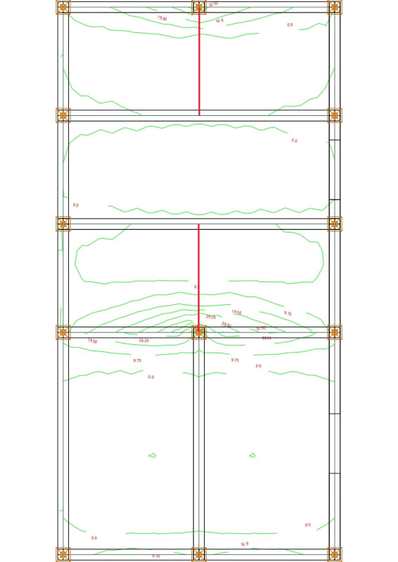

please find the attached file. The gridlines are as follow:
X: 0,4,4,4,8m
Y: 0,5,5
The picture displays moment isolines for gravity loads for DL and LL ultimate combination. Is it reasonable to have as much as 58.5 (metric units) at one-way and two-way solid RC slab intersection? And why?

The concrete doesn't care what you are calling one-way or two-way it will span based on stiffness which will be influenced by the reinforcement layout. If you don't reinforce for the moment at the interface the slab will crack and the joint will soften leading to larger deflections than your model currently predicts.
If one adds beams as in the attached image (red lines), will this redistribute the moment more evenly?
Do you mean I can change the reinforcement layout such that it will redistribute the moment evenly? How?
It is not reasonable..
I do not know the software that you have used but if peak value 58.5 unit is kN-m, the average should be in the range of 20 kN-m.
You may check your software for unit width moment values or change the model.
I think you have modelled the slab with FEM plate elements and beam and columns frame , line elements . Literally the slab supported by point at column locations and you get very high moments .
So, you think there's no effect if one combines one-way slab with two-way slab, don't you?
The title of this thread (Bending moment at one-way and two-way solid slab intersection ). My point is , the concentrated moment 58.5 (metric units) is due to column modelling rather than one-way and two-way solid slab intersection . Remove column and see the difference.

In my case, the slabs aren't flat plate. Rather, they are supported by beams (have a look at the attached image in OP).
The slabs are modeled as finite element panels, the panel will span based on stiffness of itself and supporting elements. The point support of the column is orders of magnitude stiffer than the beam, if no axial deformation of the column is considered then it is infinitely more rigid than the beam, so everything will tend to span to the interior column.
