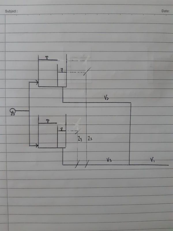

I have a tank with 2 compartments which are isolated from one another. Each compartment have a discharge outlet pipe (Q1, Q2) which combined together into a single discharge pipe (Q3) somewhere downstream.
The friction factor, length and diameter of the piping are known.
With the total flow (Q3) from the 2 compartments given, I would like to know if it is possible to determine the elevation of the water in each of the compartment. Q1 and Q2 is unknown.

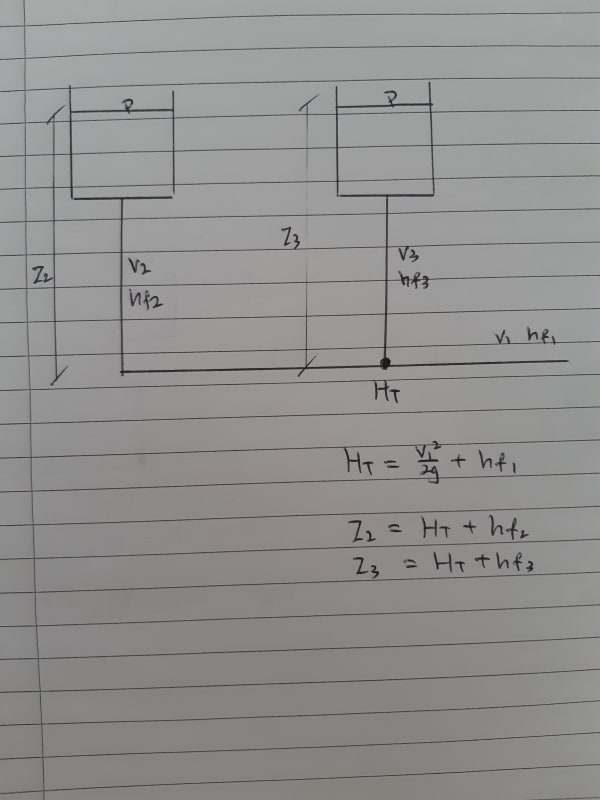

I understand the standard solution for three reservoir problem is an iterative process which begins with guessing the total head at the junction where all the pipe meets, and then with known elevation calculate the flow of each pipe. However over here, the elevation is unknown.
Appreciate if you can share your thoughts. Thank you!

Yes I am assuming both compartments to be the same level now to solve the problem. Total head HT available at the common header can be easily solved. By assuming Z2=Z3 and hence Hf2=Hf3, I can do trail and error to find the v2 and v3 which will give me Z2 and Z3 eventually. But is this method of assuming both compartments to be same level correct?
I know by connecting both compartments to a common header, the level will equalised if the there is no flow. But I would like to know the level if flow is present.
This is a steady state problem. The water from both compartment is downstream of a weir, hence there is no control of level in the compartment. However, I can keep the flow constant via pump upstream of the weir.
The ultimate aim is to find the maximum flow allowed before the weir becomes submerged.

If you sketch out the WHOLE system we might be able to figure something out...
Hello all, thank you for your replies.
As mentioned above, friction factor, length and diameter of the piping are known. v1 is known as well.
I want to solve for v2,v3,z2,z3.
If z2 is not equal to z3, I don't think I can use trail and error method. But since they are connected to a common header, will z2 and z3 going to equalised eventually?
