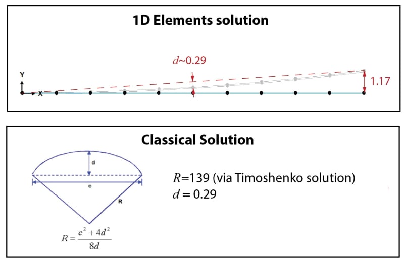

OPTION 1: Seems like this can easily be done as a "2D Solid". You model the cross section (the section shown in the upper right picture from the Wikipedia link) with quad elements. It should be easy to mesh and at the interface the nodes will be shared (essentially perfectly bonded). The effect of the Z-direction (in and out of the page in this case) is captured by selecting either plane stress or plane strain (a strip would be plane stress and wide plate might be closer to plane strain). You can run both solutions to create the outer limits (thought they won't be that much different). In this case, it is probably about half way in-between.

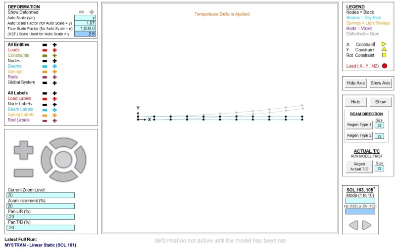

OPTION 2 (Deflection only): You might be able to model this with beam elements (but this won't give you the interface stresses unfortunately). I used the "1D Elements" program (link below) and also included an image. The deformed shape appears to be correct. The beam elements would be separated by the distance between the CG's of each strip. And each strip would be connected by stiff beam elements.
EDIT: I ran a real model with the 1D Elements program and compared it to the Timoshenko solution. The deflections were within about 3% of eachother. I would probably need to double check it though.
Brian
Thank you Brian. I made a similar model using beams and the results look pretty similar to yours. How did you arrive at d=0.29? It seems like if I pick a midpoint on the beam, the deflection is about half of the max which would be d=0.6, so I'm a little confused.

To get the most accurate "d", you might have to do some additional math. In my case, I just used the Y-component, which should be rather close (neglecting the X-component deformation and assuming small deformation). That is why I put a "~" by the d.
Looking at the dotted orange line in my picture, the Y-position is 1.17/2 at the midspan (0.585). The Y-position on of the node at the midspan is 0.292 (for my model at least). So d is about 0.585-0.292 = 0.293. I used a "c" of 18.0 btw.

I took a few days off and now I'm ready to look at this again. Thanks for your input on the d calculations. I realized my mistake was measuring d from the unformed original shape instead of the red dotted line. It makes sense now. I realized a good approximation of max deflection/4 also works pretty well for these cases. For your classical solution, how did you obtain the d or the R? I'm assuming this is independent of the model results. I get that once you have either d or the R, you can obtain the other using the equation in your pic, but I'm not sure I follow how one of them is obtained? If I used the bimetallic beam equation I linked above, I get R=101.67, which means d=0.97. I can't trust my hand calc since it's so far off...
