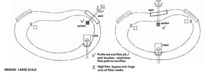

as mentioned, normally bioretention is good for frequent low flow events (eg 2yr storm) If you intend using it to retain the 10 and 100yr storm your plant selection will be important as it will need to survive being inundated for a day or two without dieing and you will also need to ensure velocities do not damage plants and or resuspend all the solids you have trapped during small events. Often the design will allow the 2yr events to fill to 150mm depth (6 in) and soak through the planted media, you will allow enough volume to accommodate the larger events with controlled outlets (if detention is your aim)but position the high flow outlets near the inlet if possible that will create a "bypass" within your pond rather than having the outlet at the opposite end and the full event flows over your plants
