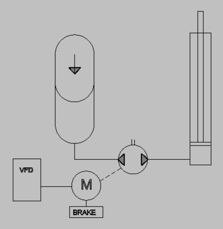

The application is raising and lowering a 4000# vertical load approximately 20" once every 120 seconds, 10 seconds to extend 20" and 10 seconds to retract 20", 100 seconds dwell. An accumulator is charged with nitrogen to approx 320 psi to offset the load produced by the 4000# weight acting through a 4" bore x 40 stroke single acting cylinder (4000#/12.566 in² = 318 psi). A bi-rotational pump is connected between the accumulator and cylinder. The pump is driven by a small motor (1/2 hp) which is in turn powered by a VFD. additionally the motor is equipped with a normally applied friction brake which is released when motor is running in either direction. By reversing the rotation of the motor the load is moved up or down with with minimum energy loss as the pump sees only the differential pressure between the accumulator whose pressure decreases and increases to some extent as the load is moved either up or down. Packing the hydraulic system is a bit difficult but not impossible.
When my guys began to test the system they ran into the following problem or at least what they said was the problem. The load lifted nicely and held when the pump stopped and the motor brake was applied. However when the load was lowered, that is when the motor was reversed the load moved down a leak was detected ot the shaft seal of the pump. I was told that this leak did not occur when lifting, only lowering. I asked them to check the pumps internal check valves to make sure that they were not fouled by something such as teflon tape or such and check the pump shaft seal to see if was damaged. While they will do this they seem to think that the pump is good but the application of using these components is the problem. As designer of the system I of course do not agree. Nevertheless I have never seen a circuit like this for some reason and as such I decided to get the opinion of others in the field.

It sounds like the pressure on the shaft seal during load lowering is exceeding its capacity. Bidirectional pumps connect the shaft seal cavity to the inlet port. The inlet port is the cylinder side of the pump when the load is lowered. How much force is applied by the load as it is lowered? What is the shaft seal pressure capacity?

2a. Sounds like your pump is not designed for bi-rotational use.
3a. What is the pump brand, model, and ID code?
4a. A minimum of energy loss? How are you regenerating the energy from lowering the load?

2b. A non-bi-rotational gear pump would act like you are describing with leaking shaft seal if the inlet port is pressurized.
3b. Is this a gear pump, a fixed displacement swashplate or bent-axis pump?
4b. All clear about design now when I see the image.

In your case the accumulator side of the pump may always be the lower pressure side regardless of pump rotation. In that case the check valves will always vent the shaft seal to the pressure of the accumulator side.
Another possibility for a leak in only one direction would be the lay of the finish grind on the pump shaft. If the finish grind was a feed grind there may be a spiral lay to the surface finish. That creates a spiral lay which can feed fluid past the seal in one rotation direction and not the other. Inspect the seal area of the pump shaft for a spiral grind which will act as a screw pump and carry fluid past the seal.

I swapped the bmp for a cropped jpg, sorry about the bmp. I've added a couple of elements to the system, pressure valves to observe what the heck is actually going on, and a hand bypass valve to be used when charging the acumulator. I just found out that my tech ran the accumulator pressure in excess of 1000 psi during the commissioning process. That would explain the blown pump shaft seal on a pump rated at 1000 psi. The bi-rotational pump is a inexpensive Northern Hydraulics (Wuxi Deli Hydraulics) model CBS-F9.6SS model. The pressure rating from Northern Hydraulics was 1000 psi while the mfgr's rating is 1200 psi continuous, 2000 psi intermittent. 1000 psi probably shouldn't have blown the seal. After reading the various comments I realized that first, at least for the startup trials I should have had the pressure gauges on both sides of the pump and secondly, I needed a bypass hand valve to initially balance the load. The actual application is raising and lowering a tank containing about 4000# of nitrile rubber mix for the purpose of coating glove making forms. This process is repeated about every two minutes 24/6. By balancing the load with a nitrogen charged accumulator, the energy used is limited to simply positioning the tank rather than lifting. Because there are many machines in a plant each have multiple tanks, the energy saving add up quickly.
I've asked my techs to replace the pumps blown seal, install the pressure gauges and bypass valve, and give it another try. This really seems too elegant a solution to give up on, yet.

What is the pressure rating of the shaft seal? It is not necessarily the same as the pump pressure rating. There would be no need for the check valves if the seal configuration has the same pressure rating as the pump.

A standard gear pump shaft seal rotating in the 1500 to 1800RPM can not hold more than 2bar. Except on some specially designed pumps that have a strong steel washer in front of the shaft seal.
The pump has internal leaks and so when you stop the pump: the load will move.
The pressure in the accumulator varies according to the stroke of the cylinder. It is maximum when the load is down.
The solution I would have put in place:
1) Connect the accumulator alone to the bottom side of the cylinder with a pressure slightly higher than the max load.
2) Use an open circuit to feed or drain the rod side of the cylinder. Or your closed circuit connected to a simple tank with atmospheric pressure instead of the accumulator.
3) Then with a little imagination a small circuit is provided to compensate for any leaks to the piston of the cylinder.
Consider a physical counter-balance weight. It is 100% energy efficient and low maintenance.

So the pump people did not give you the pressure capacity of the higher pressure capacity seal meaning the original seal did not have sufficient capacity. Now no leak depends on your hope that the seal has enough capacity.
