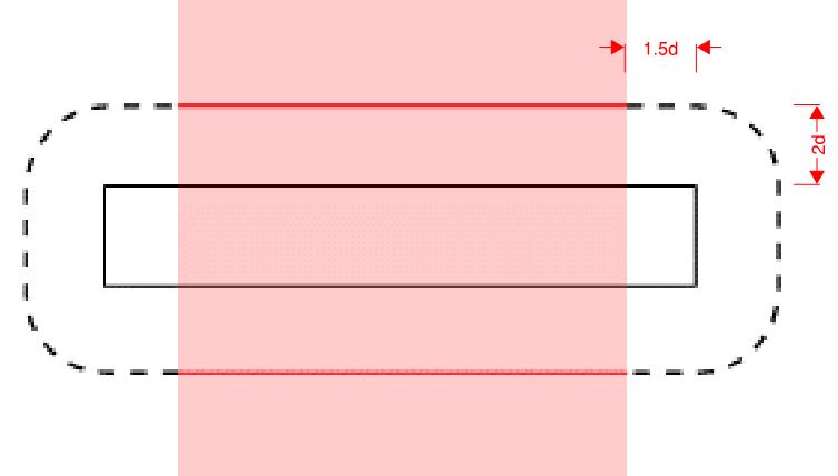

With the popularity of blade columns (wallums) with an aspect ratio over 1:4, I'd like to confirm the best way to deal with these in terms of punching shear.
At what point should you start deducting the shear going through the red hatch zone from the total punching shear (which will be assessed using the dashed shear perimeter)? It would be overly conservative to assume the total punching demand is going to be concentrated at the corners of a 2500mm x 300mm blade column.
From a purist point of view, I think you should then check each end of dashed shear perimeter separately as there may be one end receiving much more shear than the other. I know this is all heading towards the whole "...the slab will need to unzip to punch argument..."
For a straight punching shear failure check, I don't think it would matter what the aspect ratio is. The failure perimeter is what it is.
For an eccentric loading, the length along the sides that could be included is beyond my understanding to theorize about. I'm guessing it would be at least somewhat dependent on the amount of reinforcing, both longitudinal and transverse, in the slab. If I had to come up something, I probably would go no farther than the thickness of the slab down the sides past the end of the shaft.
Sorry - clarification on the extent of the dashed shear perimeter. Eurocode has the following limits. "d" = average depth of tension steel in slab.
Just eyeballing it......the critical shear will likely be one-way (on a per [unit] of length around that perimeter).

CEB-FIP Model code clause 7.3.5.2 uses only the end 1.5dv at each end of the wall as the control perimeter. The rest is ignored.
You should be ok with 1.5d as postulated in EC or modelcode 2010.

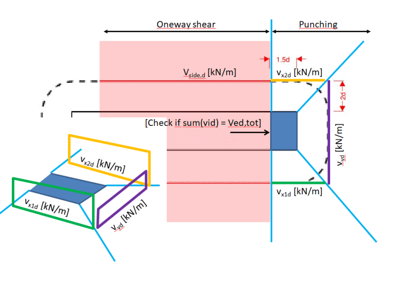

However for "long columns" or wall ends/corners we check the area of the red line like normal one-way shear along a common wall and the ends separately for punching.
The wall-ends we split up in sectors as below, so you don't have the check the whole shearforce Vd [kN] of the column or wall-end against some mixed up punching resistance. Instead use the code formulas for punching without multiplying the length of the critical section to check the shear in each sector at each wallend [in kN/m]. You can get the actions out of a FEM but be careful since the shear output is (depending on the mesh, program etc.) sometimes very approximate. Always check the reactions of the wall-end against the sum of the shear in the critical section (load transfer in the slab over the wall or numeric issues...).
Do not use Vu/Ac+Mu/J (in ACI) or the beta (in EC) to determine the max shear in the critical section. As the given example could be a bridge pillar, the vx1 and vx2 would be much larger (in the direction of the main span) than vy. The shear forces in the critical section would not be as the code formulas of punching may imply (derived from the column/wall-end reactions).
This way, you can provide the amount of shear reinforcement in each section and direction if necessary. Or at least you have a better tool the look at it in some special cases. Or get some ideas how to approach it, i wont say its the way to do it.

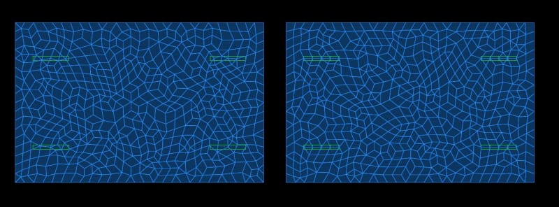

Taking this to an example.
250thk C32/40 slab. Columns are 2000x250(x3m) on 5m x 10m grid with 2m cantilevers. Live load 5 kPa. Mesh 0.5m. Left hand side modelled with single node columns and right hand side with multi-node walls.

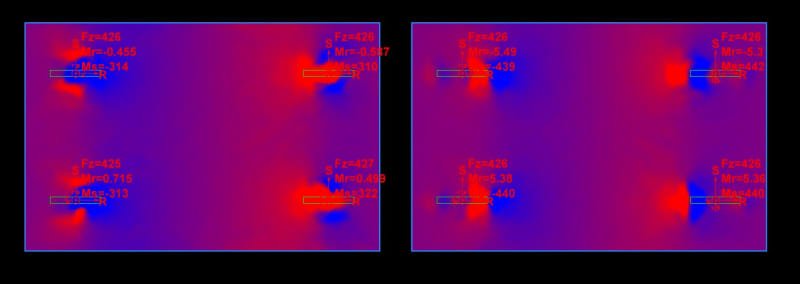

ULS Shear Stress (X)

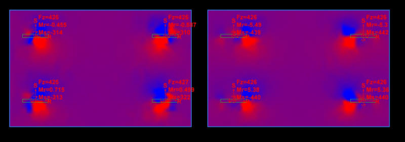

ULS Shear Stress (Y)
One-way (red hatch zone) strips according to EC2.
For the "column" model the shear going across Design Strip #3 is 145 kN. For the "wall" model the shear going across Design Strip #7 is 25 kN.
Obviously, shear is concentrating at the wall ends and therefore it would seem more correct to have these columns modelled as walls to get a more accurate shear distribution around the shear perimeter.
