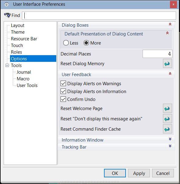

I built a blockstyler dialog that
change shape according an options
But when journal run and I choose
an option the blocks don'ts expand
and show automatically I need to
manually expand them.
What I need to do so that they
expand automatically and not manually.
Thank you in advanced.
Now I got to see that in the wheeled
Gear icon option on the dialog top left
There is a two first options
1. Is (less)
2 is (more)
and a green check mark the selected option.
Can someone help me how programmatically
choose one of them as a default.
Ok i found this option and I set it to = More.
Is it possible when I build my blockstyler dialog to set this as a default.
Thanks in advanced.

Another way that I can attacks this
Is as follows:
When selecting more option all blocks
That I don't set in my code to be set
to false is expanded.
(Block.expand = false and block.show = false).
And when I select the less option
I get some blacks expanded and some not.
If I'll know the the logic behind this
I can set my blocks so they will be
In the some expanded side.
If someone has an idea about this logic.
I'll be happy to know that.
