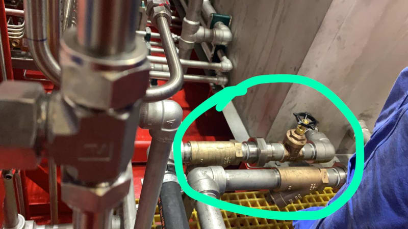

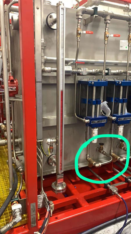

Mar 23, 2021 #1 salgu Mechanical Jan 10, 2021 5 0 0 AE Team, Please assist to correct information, In our BOP system, vendor are install brass fitting in ss line. This dissimilar material are acceptable as per the engineering standard. Attached snaps for your better information.
Mar 23, 2021 #2 LittleInch Petroleum Mar 27, 2013 21,097 3 38 GB If this is stainless 301 or 304 and Brass the risk is low. Where is your electrolyte (water etc) to form the corrosion cell? No water or electrolyte no corrosion Remember - More details = better answers Also: If you get a response it's polite to respond to it. Upvote 0 Downvote
