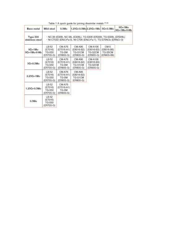

It would be appreciable if anybody could let me know simple calculation for filler material / consumables selection for dissimilar welding. Just a brief introduction into the subject would be helpfull. As a Boiler process engineer , i was told to select step by step tube material (for eg : Carbon steel-T1A-T111-T22-T91-T347H). So if i understand this welding concept , it would be usefull. To be noted , just cheked the one of the project , WE as a company TP347H is welded with T11.

You keep saying welding tube with another tube. You weld T11 tubes TO T347H tubes with a welding filler metal. Because these tubes will be at high service temperature, they should be welded with one of the nickel based (F43) filler metal as per the KOBELCO table above to transition the large coefficient of expansion/contraction mismatch between the T11 and T347 material. This reduces the shear loads imposed on the joint during heating and cooling.

@ Weldstan : Apologise i didnt use the proper terminologies. In the boiler process design we were asked to select in this order. But what i am looking for is Let take an below example from above welding handbook
Welding T22 with T11 : Filler material E8016-B2 & ER80S-G If i am right how should i calculate This base metal is the perfect match. As an engineer i can understand better if there is any workedout calculation!

For welding T11 to T22 the use of E8016-B2 is the best choice. You could also choose E9016-B3. The ER80S-G should only be chosen if it essentially meets the chemistry of the E8016-B2.
