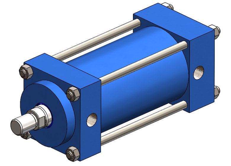

The use of long bolts provide a large volume of material,it is necessary in order to reduce the impact loading stresses and to get uniformly stressed in tension in operation.
There is tool GOOGLE ..Just write pneumatic cylinder and seacrh the web, one of the pictures below,
I could not see the problem ( using a sleeve inside the holes of a bolted joint) will you explain with a sketch?
