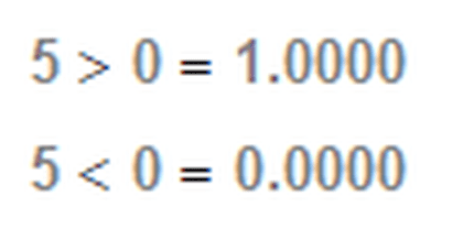

V(x) := R - (x > a) * W
never seen a ">" or "<" operator in an equality expression like this ..
How does this work ? does it multiply W only if x > a ??
else V := R if a >= x ?
if (x > a) is true (=1) then V = R-W
else if (x <= a) is false (=0) then V = R
is this the principle how this works ?
V = R - x * W when x is greater than a AND there may be more to this equation than shown in your post?
It's a cheat, based on the fact that Mathcad assigns a numerical value of one to a Boolean expression that is true, and a zero to one that is false

Agreed - it is pretty common for programming languages to use Logical TRUE = 1 and Logical FALSE = 0 (as Type INTEGER), enabling you to use this sort of shortcut. (Indeed, before the development of true Logical variable types, when Real and Integer variables were all that were available to the programmer, you would commonly define Integer constants TRUE = 1 and FALSE = 0 for exactly this purpose.)
However, a "strong" structured programming language would throw an error when you mix Logical variables (or expressions) with Real and Integer variables in one expression.
In the early days, some programming languages would return 0 or -1 for false... hence the earlier noted construction.
The expression:
R - (x > a) * W
would yield different results if FALSE is assigned a value of -1 rather than 0.
For zero (the most common value in my experience), the expression yields a value of R. For -1, the resulting value is R + W. Using Integer equivalent values for Logical expressions in a Real or Integer expression is ambiguous (and hazardous) if you're not sure of the Integer value which is assigned to FALSE.
