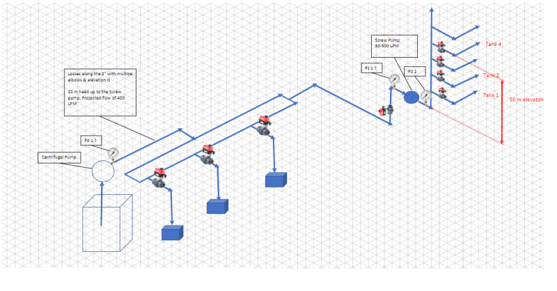

Hi Sir,
Here's the situation: We retrofit a fuel system, We use centrifugal pumps that are sitting directly at the storage tanks to pump to existing day tank which is all at level 1, pressure is less than 2 bar maximum.
Now, our end user is build a new building with the day tank on the top level 4, 50 m vertical height. Pressure losses around 6 bar.
Assuming, distance between New Pump room of PD pumps is too far away, we would need to tie in to the existing centrifugal pump in order for the PD to have sufficient NPSHa as distance is a concern and it is not economical to build a new line.
Centrifugal flow is 600 LPM at shut off head of 50 m
Centrifugal discharge line is having a calculated frictional loss up to PD pump inlet is 22 m
PD pump rated flow is 200 LPM at 5 bar
Question 1:
If the centrifugal feed the PD pump which has a lower flow of 200 LPM, would the system pressure of centrifugal follow to 200 LPM since the maximum displacement of the PD is only 200 LPM ?
Question 2:
Assuming the centrifugal is able to operate at 200 LPM curve, can I say that the centrifugal pump able to feed well to the PD pump ?
Question 3:
Would the Inlet pressure before the PD pump inlet is 22 m, which is the frictional loss or it is close to 0 barg since PD pump would withdraw 200 LPM from 400 LPM at no pressure:
Question 4:
i see some discussion, for series, we need to have a balance flow, would the centrifugal on the inlet considered balance as it would adapt to the flow the PD pump displacing
Question 5:
Can I considered the inlet pressure as 0 barg so the NPSHa shall be around 10 m absolute. Assuming the inlet is packed
Question 6:
Is it recommend to install low pressure switch at 1 bar on the inlet of the PD pump so it would protect the PD pump in case no flow.
If ever a post needs a drawing to explain this, this one does.
Please add a drawing or sketch of the system showing elevation and distances, pipe sizes, etc. [pre][/pre]
Here it is for ewveryone else
OK
Question 1:
The flow would be a total of about 200LPM. The pressure at the inlet to your PD pump could be about 20-30m head

Yes, but you need to check the pump curve of your pump. Only knowing the shut off head isn't enough. You need to know the head at 200, 400 and 600 LPM as well

No as this would be tripping all the time. You can get flow through a PD pump if there is a differential pressure, but it probably won't be harmful.
Does this help?

Your pump curve you posted is not what I would expect a normal centrifugal pump curve to look like. There are some that have that sort of drop off, but from 50m at 0 flow to 10m at 600 in straight line is quite strange. Is that from the vendor? why call it "theoretical"??
1) PD will only pump the flow within about 10% regardless of the inlet pressure. In inlet pressure is high and outlet low, then all that happens is the power consumption goes down. It doesn't overspeed.

Your pump according to your curve puts out about 40m head at 200 gpm.
According to your data at 200 gpm your friction losses from main pump to PD booster pump is 22 m.
so that leaves 18-20m as the head at the inlet to your PD pump assuming it is the only pump working and you're flowing at 200 GPM.
It is simply coincidence that your friction losses equal the inlet head into the PD pump.

If I read your system correctly, you have a centrifugal pump, pumping into a PD pump?
The centrifugal pump will only supply as much flow as the system resistance will allow. In essence, if you had an open ended pipe, the pump would pump as much fluid, as it could until it met system resistance. So if we fitted a valve at the end of the line, by opening/closing the valve, we could control the flow.
In this scenario the PD pump is the "valve".
Although the centrifugal pump could pump 600LPM through the pipe (providing the PD pump were not there), with the PD pump it is restricting the flow to 200LPM. This means that the centrifugal pump is pushed left on it's curve to the point of 200LPM (increased head).
Looking at the curve, for a flow of 200LPM, the head pressure is ~41m
You mention the friction loss's of 22m.
That means the inlet pressure at the PD pump is 41-22 = 19m
The PD pump can generate 200LPM @ 5bar.
That means the discharge pressure on the PD pump will be 5 + ~1.9 = ~6.9 bar.
If you restrict the discharge of the PD, it will keep pumping until something goes Pop!!
The increased pressure and "flow" of the centrifugal pump, will not cause the PD pump to pump more flow. NIMHO.
