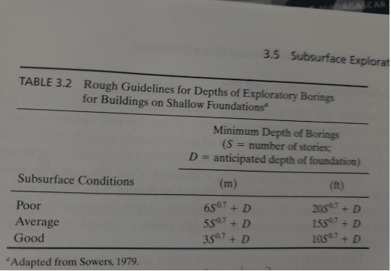

how do we determine the depth of borehole under a tower building with 4 basement and 15 stories

I think a lot of it is experience. Where I live, they typically go to bedrock every time anyway because they run into it at 30' down.
But if you need something more concrete, one geotech text I have suggests this:
Zb=10(S)0.7 (for light steel or "narrow" concrete buildings)
Zb=20(S)0.7 (for heavy steel or "wide" concrete buildings)
where:
Zb=depth to bore to [in ft]
S=the number of stories of the building
Another standard I saw once said (something like) boring to a depth where the increase of effective pressure (Δp) is equal to about 10% of the average effective bearing pressure of the structure. (In other words, to a point where the effect of the applied stress from the new structure is minimal.)

While BART's answer is clearly the winner lol I suspect most introductory geotech text should have this. See the following table from Geotechnical Engineering by Donald Coduto and Co (though this is for shallow footings only)

Double posting is not allowed .. pls look to the forum rules. Apparently , the excavation depth will be 15 m . Literally the overburden pressure at that level should be around 270 kN/ m2 or 270 kpa. If the basement floors have similar area with upper floors, the service load of the bldg (19 floors + 2 m raft ) will be 240 kN/ m2 ..
If the podium and basement storeys have larger plan area ( most probably ..) the effective pressure will be negatif..I hope the GWL is below the raft so you will not have floating risk.
Apparently excavation depth is more than 15 m , so the minimum depth of bore holes should be 30 m .
