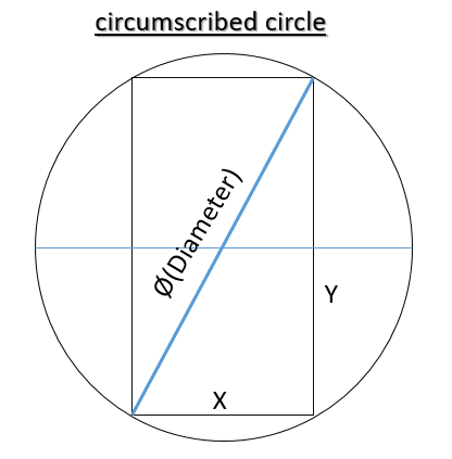

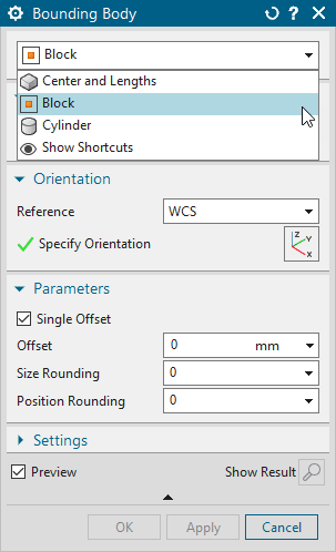

Hi All,
I am interested with thread561-366113
From that great code by COWSKI, I try to make assumption for Cylinder Diameter from base rectangle,
that Diameter Value with Pythagoras Law :
Diameter = Sqrt((boundX) ^ 2 + (boundY) ^ 2)
I have set the attribute for triggering the something like BoundType, B or C (Block or Cylinder). Also for the purpose of Inventory, The Block Size always X size smaller then Y size, and Y size smaller than Z size. But the point in this thread is about Bounding BOX to Bounding Cylinder.
The Codes is below:
The Codes is below:
