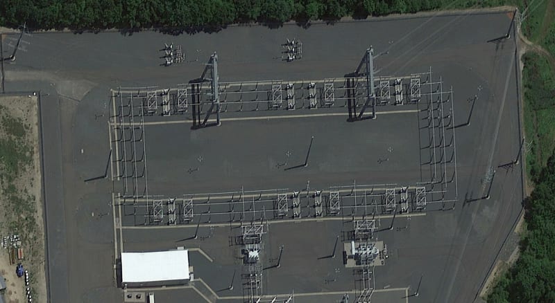

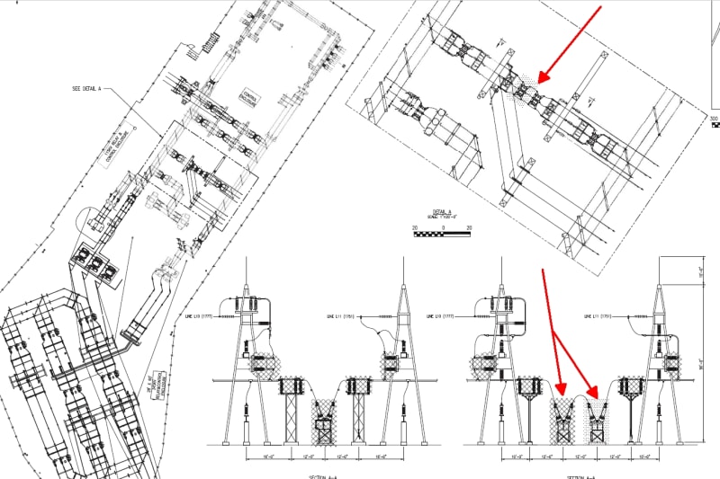

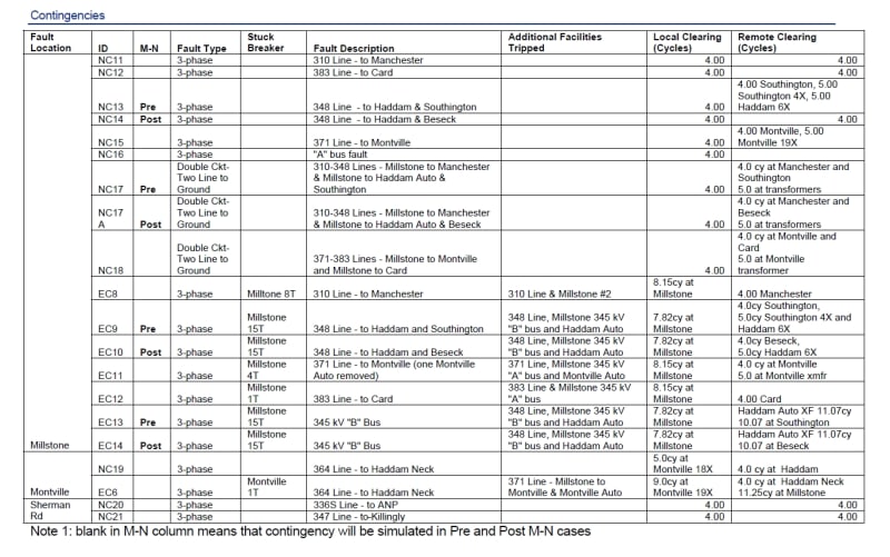

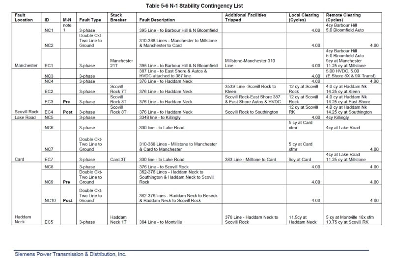

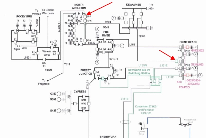

FWIW, I have even heard of engineers placing breakers in series. While not necessarily the reason in the following examples, I decided to include them if you ever need the inspiration lol. ;)
If you can imagine that the Q303 series breaker was installed during a complete rebuild of the 345kV single bus at POB. Apparently that was easier than converting the existing single bus to something more flexible. The first time I saw L121 with the existing series breaker, I could not for the life of me understand what purpose it was serving.
At Millstone, even if the primary breaker trip time (7.82 ms) is larger than the secondary breaker trip time (4 ms), still the total clearing time (11.82 ms) would be less than the critical clearing time of transient stability study, so it should be Ok.

@thermonic1: Yup- a lot of times series breakers are used where a stuck breaker produces unacceptable results by clearing two or more elements. Its not just existing straight bus installations but also new breaker and a half substations where clearing the neighboring circuit for a stuck center breaker violates thermal or voltage criteria. Buss and neighboring element outages coordinated at load or generation dispatch where both elements out is not a concern.
