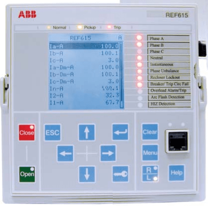

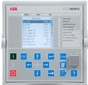

I'm used to seeing ANSI devices with Red=closed, Green=open.
And IEC devices with Green=closed, Red=open.
Here are the ANSI and IEC version of the same ABB relay for reference.
ANSI
IEC
