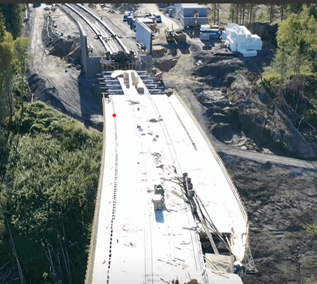

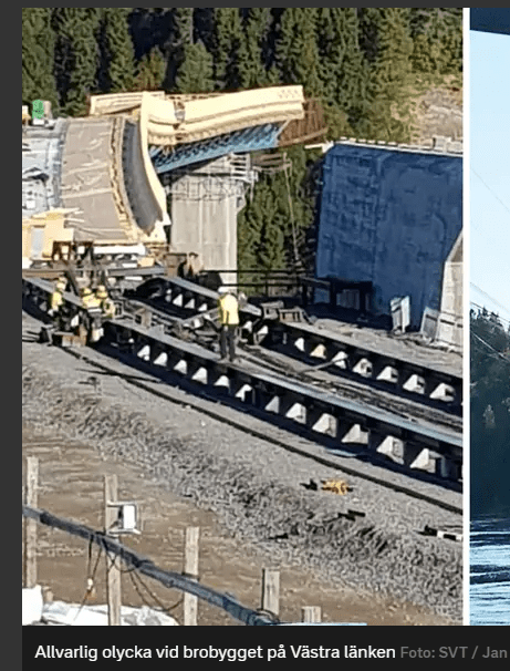

Took a while to figure this out, but from the text and the drone footage it appears that when sliding the bridge out it went too far and fell off the end of the rails, so a failur in the hold back mechanism.
The land side of the bridge then fell 10 to 15 m, the bridge bent over the first support and I guess the temporary structure and cables designed to give it strength as it cantilevers out over the span then failed / got shaken and fell off. See the snippet below which shows the bridge falling off the end of the rail system. I guess that last section is supposed to be inside where the walls are
Everything else is collateral damage.
LittleInch: Seems resonable. Here's another picture from the launching side.
The articale mentions a "king pin" coming loose. Not sure what that refers to (not a bridge guy).
"The article mentions a "king pin" coming loose. Not sure what that refers to "
Probably the bridge equivalent of the "Jesus Nut" found on some helicopters
Seems to refer to the temporary suspension cables / post which I think fell off after the original failure.

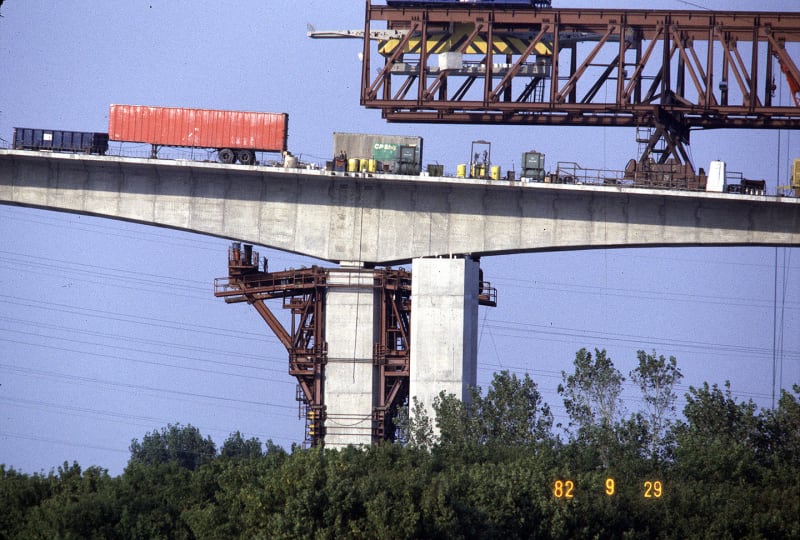

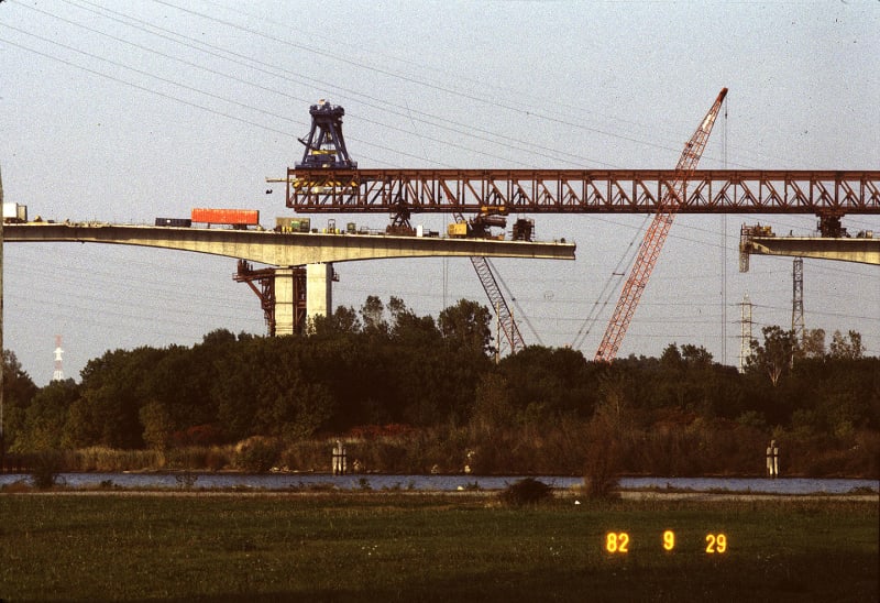

Something similar to this happened back in 1982 in Michigan during the construction of the Zilwaukee Bridge over the Saginaw River. Construction started in 1979 and was supposed to have been finished by 1982. However in August 1982 they were only about 2/3 completed when an accident occurred where supports holding a section of the bridge failed and one end dropped about five feet and another section lifter up three feet making sections eight feet out of alignment. Between firing the general contractor and hiring a new company, figuring out what went wrong and how to salvage as much of the work as possible, if took another six years before the bridge was finally opened to traffic.
Note that we lived and worked in Saginaw when the project was started and it was a big deal because I-75, the main North-South freeway in the state, and as it crosses the Saginaw River it did so via a drawbridge, the only one along the entire length of I-75, which runs from Key West, FL to the Canadian border in Michigan's Upper Peninsula at Sault Saint Marie. Now upstream from this bridge was a couple of General Motors foundries and at least once a day, the bridge had to open to allow a ship called the 'Niagara' to pass (note that for each passage, the bridge had to open twice, for both the upriver and downriver trips}, as it brought sand that was dredged from Saginaw bay and used as casting sand in those two GM foundries. Now this would cause some monumental traffic back-ups particularly if it was on a Friday or before a holiday as thousands of tourists went up to the Northern parts of the state during the summer months and in the fall, especially during hunting season. So the decision was to build a bridge high enough allow the ships to pass. They also had to come-up with a scheme to do this without interfering with the river traffic so that's why the used that pier and truss approach.
Anyway, here are some pictures that I took shortly after the accident:

A few comments from the videos and description of the failure. The bridge looks to have both a launch nose and a temporary king post, which is fine but unusual for the launches I have seen. Given the king-posted arrangement, the king pin is most likely the pin at the base of the king post. Seems an odd point for failure to originate, if that is the case. Cost of upsizing that pin versus the king post itself is tiny, and compared to the overall project is microscopic. Something like that is often given larger safety margins due to the cost of the item versus consequences of failure.
