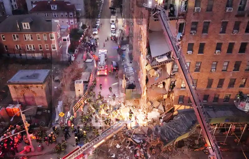

1915 Billingsley Terrace in the Bronx
Link

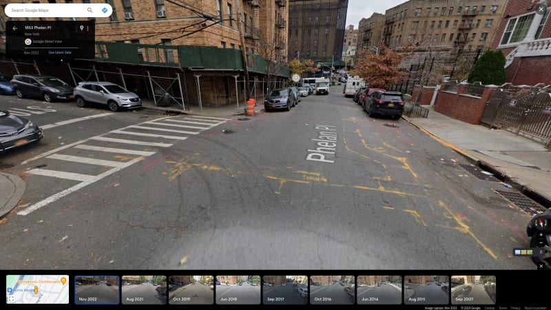

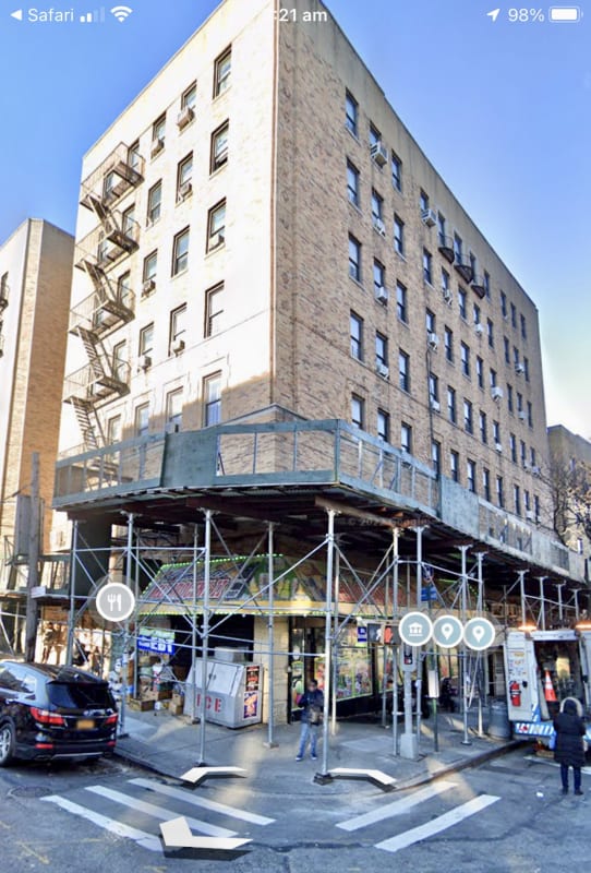

Google maps street view shows a contractor scaffold wrapped around the perimeter of the building at street level.

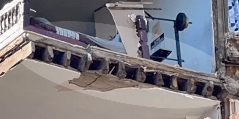

Engineer: I’m designing this floor with simply supported joists.
Simply supported joists: hold my beer

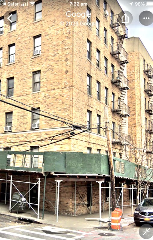

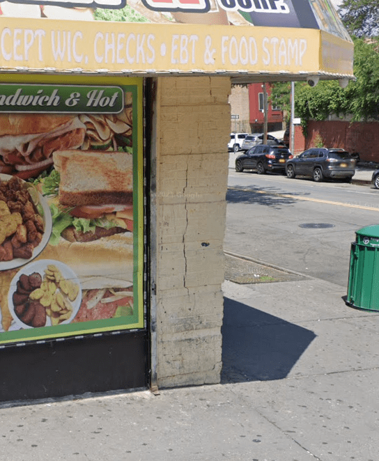

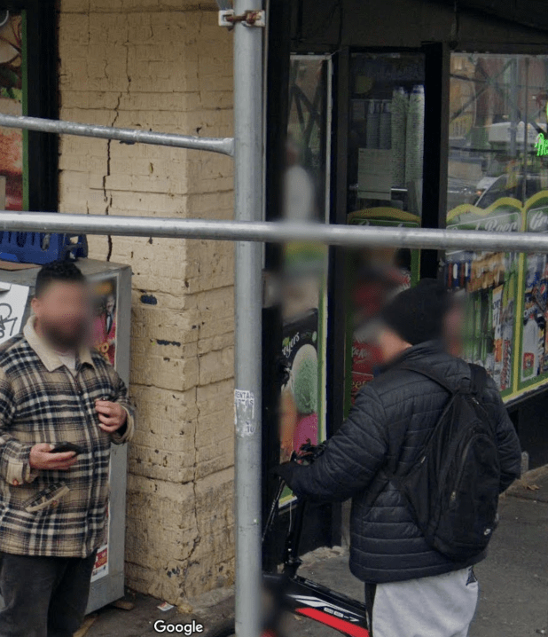

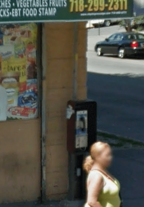

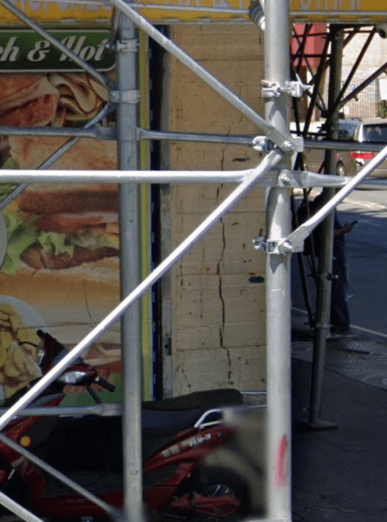

Large cracking at first level at corner of collapse. seen on google street view
ABC7 Article said:
Department of Buildings Commissioner James Oddo says that the owner of the building submitted their most recent report in March of 2021, which found seven open violations, including "unsafe facade conditions."
A 2020 inspection found cracked brick and loose, damaged mortar on the building's facade, Buildings Department records show. Oddo said Monday that work had started but he didn't believe any workers were there at the time of the collapse.
"I want to be clear: Unsafe facade conditions is not the same as an unsafe building," he said at the news conference. While the property had seven unresolved violations, they weren't structural, he said. Five of them were Office of Administrative Trials and Hearings (OATH) and Environmental Control Board (ECB) violations, while the other two were DOB violations.

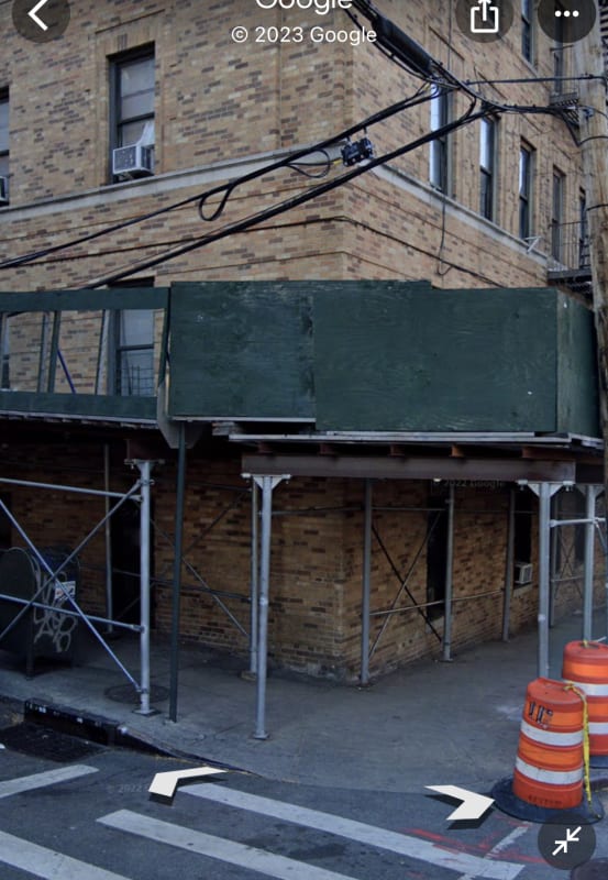

From google street view:
Aug 2011
Jun 2014
Sep 2017
Aug 2019
Aug 2021

From the Davenport lessons, exterior cracks in the outer wythe are clues to crushing of interior wythes. As the brickwork deteriorates, the interior wythes are left carrying the weight of the floor space while the exterior wythes no longer participte. The hidden damage behind interior finishes is far more grave than exterior presentations suggest.
I agree that the official declaration that facade issues are not structural issues completely misses the point. This lack of familiarity was a highlight of the Davenport collapse as well.

It's also important not to over simplify things. While it may be that there are issues here that mirror Davenport, 2 data points in a sea of thousands of multi-wythe brick buildings does not a law make. I've seen a lot more than 2 brick buildings with cracking in the exterior where that, when the outer bricks were removed to repair it, the inner brick was in decent shape.
This does show the importance of crack monitoring, though. When a crack appears on a building and its cause isn't immediately evident, monitoring it should be one of the first things that gets done. Would have likely forced an intervention in this building by 2019.

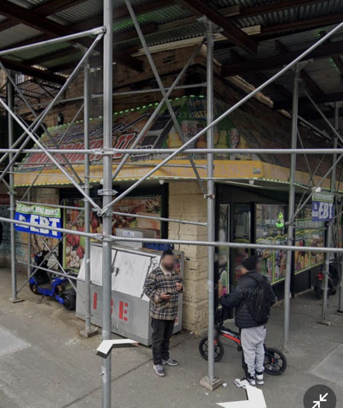

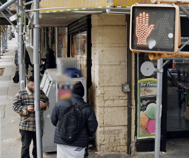

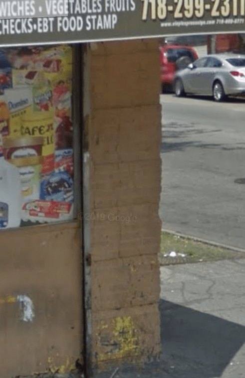

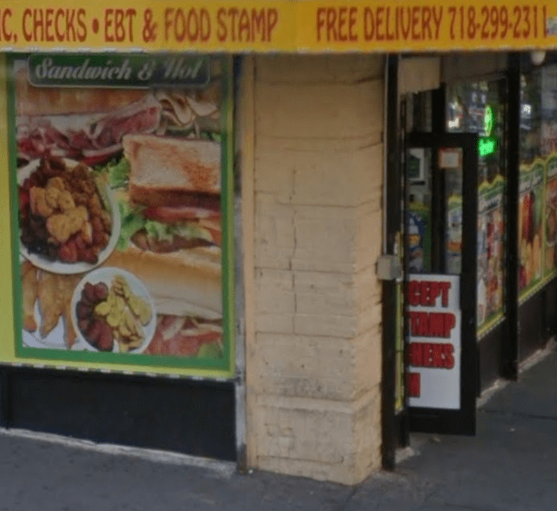

At that corner (where the store was), there are noticeably fewer walls compared to other corners, possibly due to commercial modifications aimed at expanding street frontage. The corner pier appeared to be carrying a lot of facade. Compare it to other building corners:
Yes, makes one wonder if the bodega (had to look that up) was always there or if some vertical supports have been removed to make way for the storefront.
I just did a rough check, and assuming it was a brick pier, it was overloaded. I suspect it simply burst.
Depends If the corner post is just brick, it has a very different capacity than if the corner post has a steel post in it. Available images can't answer this question.

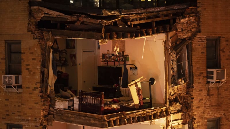

I concur with the opinion this is a building where the entire thickness of the outer walls were intended to be structural. 100+ years ago this was how things were done. At that time steel building frames were relatively new.
[URL unfurl="true" said:
https://en.wikipedia.org/wiki/Steel_frame[/URL]]The Home Insurance Building, completed in 1885, was the first to use skeleton frame construction, completely removing the load bearing function of its masonry cladding. In this case the iron columns are merely embedded in the walls, and their load carrying capacity appears to be secondary to the capacity of the masonry, particularly for wind loads. In the United States, the first steel framed building was the Rand McNally Building in Chicago, erected in 1890.

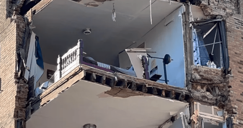

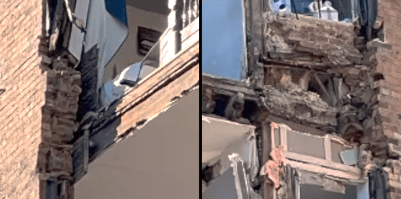

As much as the obvious east facing crack appeared 12 or more years ago, the north facing crack fully developed in the last 3-4 years, at least from what I can discern from the Street view library. If Tomfhs calculations were for an intact column, how much worse was the loading as the column disassembled. One witness stated the collapse progressed from the top floors down, which is contrary to the column exploding.
Another detail of import is the decorative setback in the northeast corner of the upper floors. Did this aggravate an eccentric load for the corner column. It would seem the floors were tied into the structural brick only on the north face. How did that impact the column loading.
P.S. I hadn't considered the possibility of a steel post. Davenport only had perimeter steel on the expensive part of the building.

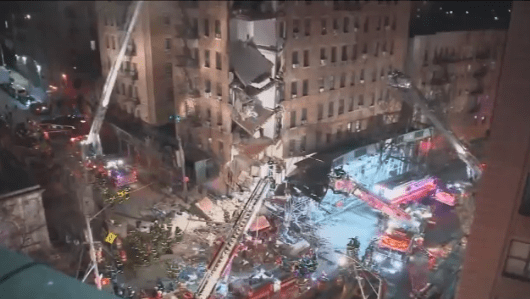

Also, in this situation, only the brickwork came down. The remainder of the structure is still largely in tact.
Eyewitness accounts are extremely unreliable, but it will be interesting to see any security footage.
