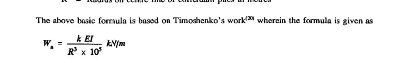

I am new to secant shaft design and I am reading some of the previous calculations when I noticed a buckling check using this formula for the critical buckling load Tcritical=3*E*I/r^2.
If someone knows a reference I could read to be familiar with this formula? For more information, the shaft is only laterally loaded with earth pressure and water and no axial loading. I assume the buckling check is for the secant shaft giving in radially? Not sure.
Thanks alot!

I might be driving beyond my headlights here being a geotech, but shouldnt buckling be linked to the shaft length? Why is r (presuming its radius) used?
EireChch, there's no axial load in this case so it isn't buckling like a building column. This check is for the circular cross-section buckling into an oval shape, while the pile remains vertical.
The page I linked to (and suspect is the situation that HanStrulo's calcs are meant to check) assumes uniform radial pressure. I'm picturing it's a simplification of the real situation, which would have unequal pressure on the active and passive sides, and no pressure along the length of the wall (shielded by the neighbouring secants).
Thank you everyone for the responses.
I asked about the origin of the formula and my colleague directed me towards CIRIA 95 (the design and construction of sheet-piled cofferdams), this is an snapshot of the formula
It's from Timoshenko's beam theory apparently.
I tried to get into it in depth but i found it too time consuming so i just used the formula from CIRCA 95 as is to check for buckling under uneven earth pressure.
if anyone has a good book or a simplified version of the proof to the formula, I would really appreciate it.
Also, it should have been to the power of 3. I apologize for the mistake.
