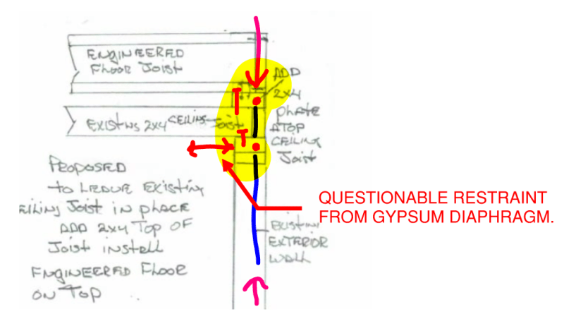

Good Morning.
I had a contractor reach out to me about building a second floor addition on top of the first. However, he would like to leave the existing attic joists as is to avoid removing drywall on the floor below.
I've attached a sketch of what he proposes. My question is does adding an additional floor system without removing the old create an additional hinge that needs to be examined ? If so how could this be remediated ? Maybe add thicker sheathing on the outside.
Thanks for your help guys.
I assume you're concerned with out-of-plane wind loads on the exterior wall and the connection between the top of the wall and the existing ceiling / new floor diaphragm. If that's the case, then if the existing connection between the wall and ceiling is adequate, I wouldn't mess with that. From there, assuming that you want the load in the ceiling diaphragm to transfer into the new floor diaphragm, I would look at providing connections between the ceiling joists and new floor joists.
This could be accomplished be aligning one side of the new I-joist with the side of an existing ceiling joist below and connecting the two with a plywood gusset plate. You probably don't need to do this at every ceiling joist, although that depends on your loads.
I would add blocking between all of the existing ceiling joists on top of the existing wall top plate.
And they need to remove the existing exterior wall sheathing and replace with sheathing that is continuous thru the old ceiling, new floor and the studs above and below.
Is the existing 2x4 exterior wall good for the added second story loads above?
Yes, it does. And it's rather keen of you to pick up on that. Per the model below, you would be forever relying on the ceiling sheathing to act as a diaphragm to stabilize the system under gravity loads. Maybe you're cool with that and maybe you're not. It's certainly been done, for better or worse. It doesn't take much to brace something like this for gravity loads.
I imagine that you would have to turn the ceiling joist system into a diaphragm that you do have confidence in. Some options:
1) Sheath the top of it with wood panel sheathing entirely.
2) Block and sheath the top of it with wood panel sheathing in a doughnut shaped ring around the perimeter.
3) Install in plane diaphragm trussing in the form of 2x diagonals attached to the top of ceiling joists.
4) Install some substantial LVL on the flat around the perimeter to be the perimeter diaphragm.
Obviously, all of these solutions have the potential to mess with the economy that your contractor hopes to achieve with this. My guess is that #3 would be the preferred solution with respect to cost.
I'm gonna have to disagree with KootK.
The 2x4 plate between the old and new will transfer the shear load up into the new floor diaphragm. Regardless, we count on sheetrock ceiling diaphragms for restraint in basically every house with a gable roof or where the floor joists run parallel to the exterior wall.
Unfortunately, that does nothing to stabilize the low hinge in my sketch above which, I believe, is the core issue for OP here.
I agree that is often done but it's sketchy and there are other ways:
1) For a gable roof, you've got the ugly diagonal bracing from the top of the wall to the roof sheathing.
2) Where floor joists run parallel to exterior walls, there should be blocking to connect the tops of the walls to floor sheathing.
Actually, you're right. I see it now. That's actually what I was getting at with the two fasteners that I showed in my sketch but, somehow, I got turned around.
That mechanism applies a moment to the end of the joists where there compression flange would be unbraced but that's probably not much of a concern. Maybe just throw a line of blocking a few feet in from each end of the ceiling joists.
Thanks for the correction.
