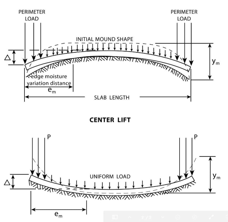

In central Texas, where horrible expansive soils are fairly prevalent, post tensioned slabs on grade are designed using the PTI method. These are stiffened (ribbed) slabs and the depth and spacing of the ribs is determined from the PTI equations to resist differential slab movement and to ensure tensile stresses in the slab do not exceed a threshold. At the minimum, ribs are typically 24" deep at 15 ft spacing each direction. Depths of ribs will increase (sometimes as much as 36"-48") and spacing of ribs will decrease depending on how expansive the soils are and your loadings. Bearing capacities are checked by assuming all loads transfer from the slab to the ribs then to the soils.
Basically every project requires a geotech report. The geotech provides the 4 critical PTI design values, em (centerlift and edge lift), ym (centerlift and edge lift), and allowable bearing capacity. The slab is designed using a uniform slab load (PSF) and a uniform perimeter line load (PLF). All of these values are plugged into the PTI equations and the beam depths, spacing, and number of beam and slab tendons are adjusted until you get acceptable values for differential deflections and stresses. I would recommend to look at this spreadsheet if you want to get familiar with the equations and workflow of designing a post tensioned slab.

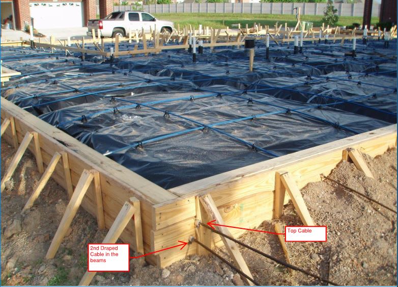

The big question on your proposed add-on is: Do you dowel-in the new slab? Or, let it float free? I'm inclined to say that you want to dowel in, but you have to worry about hitting an existing cable in the perimeter beam. To help aid this decision, I would attempt to verify if you have a single cable system (top only), or do you have a second draped cable. You can go to the corner of the slab and see how many grout pockets are there to figure out. I'll try and find a photo.
