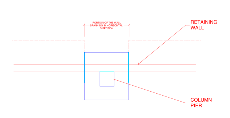

Can't you just form it out with some pt wood to separate them separate them during the pour? I can't imagine losing that small part of the retaining wall footing would be an issue and can be designed for.
If I understood you correctly, what you are saying is to provide a standard spread footing for the column at same depth by notching the retaining wall footing. The wall however will need to span the width of the spread footing in horizontal direction, something similar to the sketch below. Certainly an option but seems a bit complicated. Something to consider though in case if my origional concept is going to cause major issues.
Don’t bother trying to separate them. Just make it sufficient sturdy that the wall isn’t going to lean over and causes issues.
I have been doing some research on impacts of compaction during backfilling operation. For externally stability, typically I have desgined the retaining wall using active earth pressure and live load surcharge to satisfy sliding and overturning requirements. I ignore any impact of compaction pressure for sliding and overturning considering that the wall will move during the backfilling operation. Ofcourse when it comes to the design of the wall stem in bending, I consider at-rest pressure with live load and compaction surcharge.
One thing that I do not know how to quantify is how to determine the amount of wall movement during backfilling operation. FOr some reason I think it is important for me to have an idea on the amount of movement during backfilling operation caused by sliding. Becasue if the wall shifts horizontally say by 25-50mm, building steel is no longer going to fit.
Perhapse I am overthinking this issue and the amount of movement during backfilling are minor that it will not be a concern.

Beef the retaining wall up a bit to improve its deflection and lateral movement a bit. The pour your conc. column pier as an integral part of the retaining wall, up to the top of the retaining wall, and set your steel col. at that elev. with epoxied A.B’s.
I'm think it would be easier to keep the footing continuous across the region where the column is.
But do you have enough room to increase the footing size? For example, if your overall footing (toe+heel) is 8ft wide, do you have room to increase it to 12ft wide at the column. Maybe the footing bumps out 5 ft before and after the column?

Space is also a challenge. I can extend the footing towards the inside of the building but restriced on the out side.
