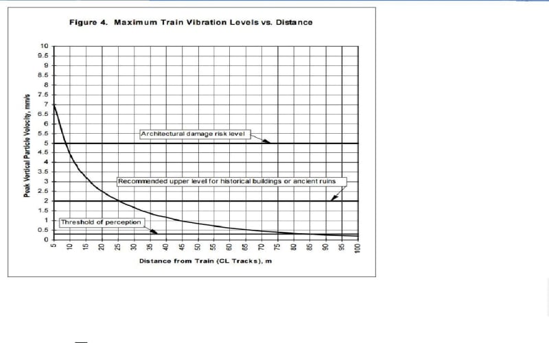

Hello,
My questions are related to buildings near railway lines in Canada.
Are there any specific requirements for building foundations that are in close proximity to railway lines?
The building is commercial.
From what I have researched, the main issue would be vibrations due to railway traffic.
Is there a specific distance under which the vibrations have to be considered?
