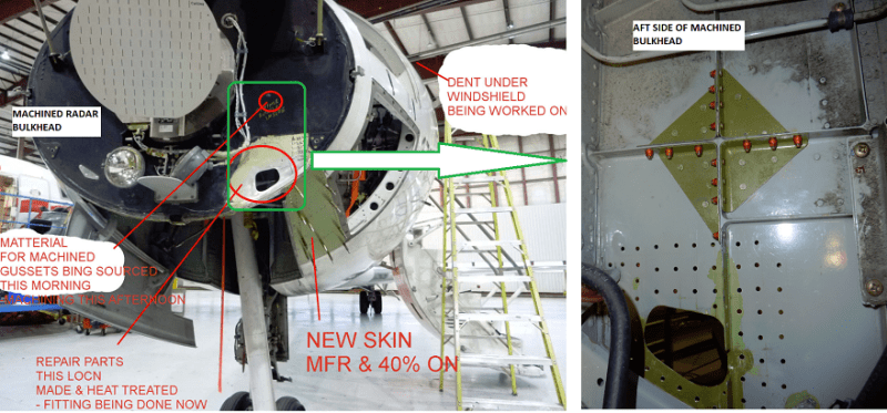

Cannot seem to avoid adding my comments to this issue ..
Design is a nice initial objective for the 'office boys' - but my perspective always involves the repair 'addendum' - something that is rarely considered these days .. In today's 'my problem ends when the aircraft leaves the shop' world; has anyone considered the in-service replacement of the bulkhead? The design initially provided would be a failure - requiring significant disassembly & Mr. Taylor's design would be acceptable .. Should the aircraft be damaged; has any consideration been given to repair or replacement.
I am still in awe at how little communication there was between the designers & the in-service engineers. For example an early series had a crack at a floor / formed-frame intersection. They redesigned the structure with machined frames but managed to incorporate the same crack in their latest design. No one seemed to have the time (or concern) to review some history of the area ... and /or in their minds .. "not my problem"
Edmeister...
I get where You are coming from... the lessons learned from best practices and experiences don't ever seem to be re-incorporated into the current design... and when failure occurs, then repair becomes difficult to impossible... resulting in need to repair/replace structure that is embedded so deeply as to require heroic efforts to repair/remove-replace [RRR]. The situation is bad [but usually getting somewhat better] for aircraft still in production... but getting a LOT-worse for aircraft out-of production and getting older-by-the-day.

Hopefully i am not leading off topic ..
My greatest peeve is a recent regional jet where the 1-peice radar bulkhead and fwd pressure bulkhead are located inside the fwd sloped nose cone of the aircraft. Given the convex nosecone shape & sloped bulkhead flanges to accommodate .. there is no possibility of replacing either item without peeling back several feet of side fuselage panel & somehow enlarging the opening for the correct diameter for bulkhead insertion. These items are both 1-peice machined, limiting any type of repair ... and what is most hilarious, is that the radar bulkhead has huge openings for weight saving. I can visualize the goose (bird) crashing through the radome, managing to line up with one of these radar bulkhead openings and ricocheting off the fwd bulkhead (only 8" away). And when this happens .. no less than 6 months of RRR! (as Mr Taylor refers to it) .. Should they have designed the bulkheads as an assembly of smaller parts / individual parts would have been much easier to RRR. ... or per my previous post .. had any of these engineers reviewed past experiences with bird impact; they could have anticipated the result - and selected a more feasible assy for field repair...

Ed, instead of trying to replace a one-piece bulkhead with another, and doing (as you say) lord knows what sort of damage to the skin panels, you could design a multi piece bulkhead.
and if you've had a bird strike, what damage to the surrounding panels ? maybe replace everything, maybe to a couple frames aft ??
rb1957 ..
Skin panels are usually large skin panels .. replace / splice / or scab as required is usually done. But the bulkheads are another story. The impact usually buckles or distorts the shape - thus replacement of bulkhead easier than machining custom widgets to fill-in the damage cutout - & thus we have the problem! The 'UN-pressurized' radar bulkhead is obviously easier then the fwd bulkhead to repair. Fairly easy to get most repairs approved. But the fwd Bulkhead due to damage tolerance considerations will only allow the 'pettiest' of repairs. The OEM just shrugs & and determines "replace'. Also note we have avionics, instrument panel, & nightmare galore one the aft side of the fwd bulkhead. The old days where bulkheads used to be made from multi-part assemblies were the best solution. Today, 1-piece machined 'ingots' of aluminum may be initially cheap to mfr & install .. but quickly get expensive to repair.
Also .. if a crack shows up in a multi-piece assy, repair usually consists of replacing the crack component. Today, when a machined bulkhead gets a crack, get out the CNC (to fab custom repair widgets) & hope there are nearby areas / spaces / landings where fasteners can be installed & access is available (see above about nightmare galore). !
Attached pix is a simple repair to a machined radar bulkhead. Lots of room & space to work with. Option to replace bulkhead also considered. An early version of same bulkhead 'multi-part assy' would just have required the replacement of a few parts. What an extra chore !
Hmmm... Doesn't look like most pressure bulkheads I'm familiar with.
