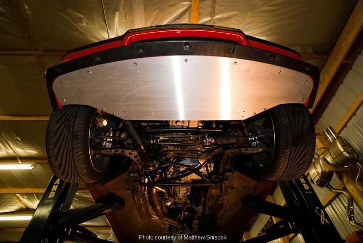

Here's the best image I can find. It's from under the car looking towards the left (i.e. right on photo is front of car).
Note how the steering arm is quite close to parallel with the cross-car portion of the L-shaped lower arm. The bushing on that leg of the arm is stiff so that the steering arm and that leg of the lower arm are a parallelogram. The bushing inside that aluminium bracket is squishy to let that parallelogram work fore-and-aft a little when there's a bump impact.
Thanks for digging up the nice pic.
So if I'm understanding this correctly, when a bump tries to push the lower ball joint back, the arm pivots around the stiff bushing at the upper right.
Given that the angle is roughly 45 deg from the BJ to the upper left bushing, the latter would have to be allow as much radial as axial deflection, so presumably this car is aimed more at ride comfort than handling precision.

Little bit of confusion here I think. The bushing on the left in that photo is under basically zero axial load; all load on this bushing is radial (up or down in the photo; near-zero force left/right). BMW used this arrangement in the front for decades, specifically through the 3-series until the E92, and that series of cars were known as some of the best handling cars ever produced in their class.
In the BMW version (pic below) the horizontal bushing in the photo Brian shared is not a bushing- it's a rather large ball joint, which provides articulation of the arm in all directions but zero longitudinal movement of the arm, which means the bushing to the rear (in the BMW system, the only bushing in the system) sees radial load only.
