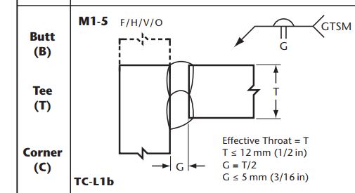

Curious if anyone is aware of a prequalification for the weld shown below. It feels like a 'hold the plate in place' sort of weld. It's a 1/2" plate on top of a W12x65. TC-L1-GF/S comes close, but maxes out at a 3/8" plate. This stuff is existing, and we're adding a small moment to this plate. If I ignore prequalification, then it just barely squeaks by...but if it's not prequalified I can't really put load on it.
(I say existing...this is under construction and I've been asked to design the connection of a component to this column...my gut tells me to add flange plates to the column and be done with it, but it's going to cause a fight with a big firm that I'd like to avoid if there's an ethical way of doing so. The owner is under the impression that this was designed to receive the piece we're adding and my check is more or less a pro forma activity...if I start calling for all sorts of field mods and fabrication it'll likely cause a stink.)

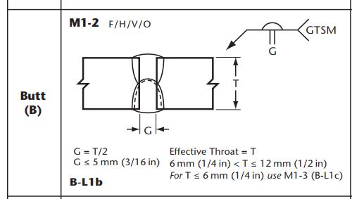

Anyways see if these from CSA W59 work for you (not quite what you need but may help you feel better?).
No, can't change the details. It's already in place. I can add more stuff using bolts (it's galvanized, so field welding is frowned upon for good reason), but what's there is staying.
Your TC-L1 is a little more accommodating with the member thickness. Do those require backing, though?
Requires a "back weld" but not a backing bar.

Well I've combed through AWS D1.1, and as far as I can tell this doesn't exist as a prequalified corner joint. So I'll let the fabricator produce a PWS, or they'll have to drill some holes and bolt through the flange. C'est la vie.
I agree with your conclusion phamENG, I have gone down a similar path previously and came to the same conclusion.
