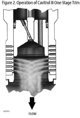

Let us look at this pic
, in this pic according to me the fluid pressure is dropping two times that is at the starting point of the orifice or hole and second time at the point where the convergent nozzle starts. So if the pressure drop occurs twice then why it is called as one stage trim?
Also if you have any related resources related to the general design procedure of cages in industries then please provide it to me.
Because the first "stage" as you call it is negligible compared to the second so most people would view this as a single stage trim.
