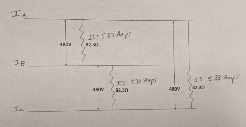

I have three electric heaters with resistance 82.3 ohms each, wired in a delta configuration as shown on the left below. As I see it, each 480 VAC line-to-line voltage is applied across a parallel circuit as shown on the right below.
I calculate the total resistance of the circuit on the right as 54.87 ohms. The formula I = E/R = 480/54.87 = 8.75 amps leads me to believe that my expected current draw on each line would be 8.75 amps, but I am not entirely confident about this.
I am not sure if the delta-configuration introduces any complexity that would make my simple calculation invalid.
If anyone can tell me if my calculation is correction and if not, how/where I went wrong, I would greatly appreciate it.
Thanks in advance,
Paul

Hi sushilksk,
Thank you for your response. Your rearranged drawing makes me believe that with line-to-line voltage of 480 VAC, the current through each resistor (indicated by I1, I2, and I3 below) would be 5.83 amps.
What I am still not clear on is how to determine what the currents will be at IA, IB, and IC. The illustration makes it look like IB is feeding both I1 and I2, but being this is alternating current and not always flowing in the same direction, I do not think that IB = I1 + I2. Am I right?
I know in 3-phase circuits, a factor of 1.73 sometimes comes into play. Would IB = (I1 + I2) / 1.73 ?

For a balanced load the line current is 1.73 times the phase current.
For unbalanced loads you must take the directed sums of the phase currents.

Hi Bill, IRStuff, mparenteau, and sushilksk,
In response to Bill, my 3-phase delta circuit is actually not a transformer. It is just three heaters of the same resistance. I agree that the diagram that sushilksk sent (below) accurately represents my connections:
With this being the case, can I assume that this is a balanced load, and therefore my line current IA = IB = IC = 5.83 * 1.73 = 10.1 amps? This is what I come up with using the Watlow calculator referenced by IRStuff as shown below:
What confuses me about this Watlow calculator is that it only shows the line-to-line voltage applied across the points I have labeled "A" and "B" on the delta, whereas in reality, I have line-to-line voltage applied across A-B, A-C, and B-C.
Am I using this calculator correctly?

When two directed vectors with a unit value of one and at a displacement of 120 degrees are added the arithmetic sum is two units,
but the directed sum is root three units.
Just use 1.73 times the load current for line to line loads on different phases.

Thanks Bill,
Just to make sure I am clear, when you say "just use 1.73 times the load current for line to line loads on different phases", am I correct to assume that in the diagram below, what I have calculated as 5.83 amps (480 VAC / 82.3 ohms) is the correct value to use for "load current". If this is correct, I believe this would indicate my expected current on each line (indicated by IA , IB, and IC would be 5.83 amps * 1.73 = 10.1 amps. This is the same value I came out with using the Watlow tool, so I am fairly confident that I am on the right track. I just want to make sure. I really appreciate your help. Thanks and best regards, Paul
Hi Paul:
To avoid minimize rounding errors lets run 480 Volts / 82.3 Ohms x root three on the calculator.
= 10.1018759129169‬ Amps. 10.1 is close enough for me.
Bill

We can slove like this:
Now vector calculation I1 = IR1 - IR3 = 5.83 - 5.83 (120˚) = 10.09 A
