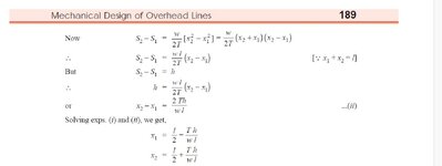

I am having difficulties understanding the calculation of the weight span for spans subjected to wind loading in overhead power lines. Do I still have to consider the lowest point to define the weight span, or do I have to consider the lowest point of the catenary in the coordinate system of the inclined plan? I created a short gif to explain what I mean. The point shown in the gif is the lowest point of the catenary in the plane of the catenary, but not the lowest point if we look at the "z" coordinates.
