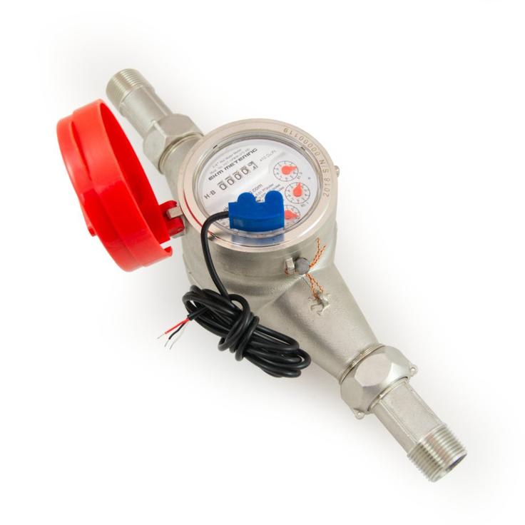

34-hot-water-meter-stainless-steel-high-definition-pulse-output-606026_736x736_wh1jmm.jpg
Lots of those rated for hot water!
$150 and you'll always know what's happening.
[URL unfurl="true"]https://www.ekmmetering.com/collections/water-meters[/url]
