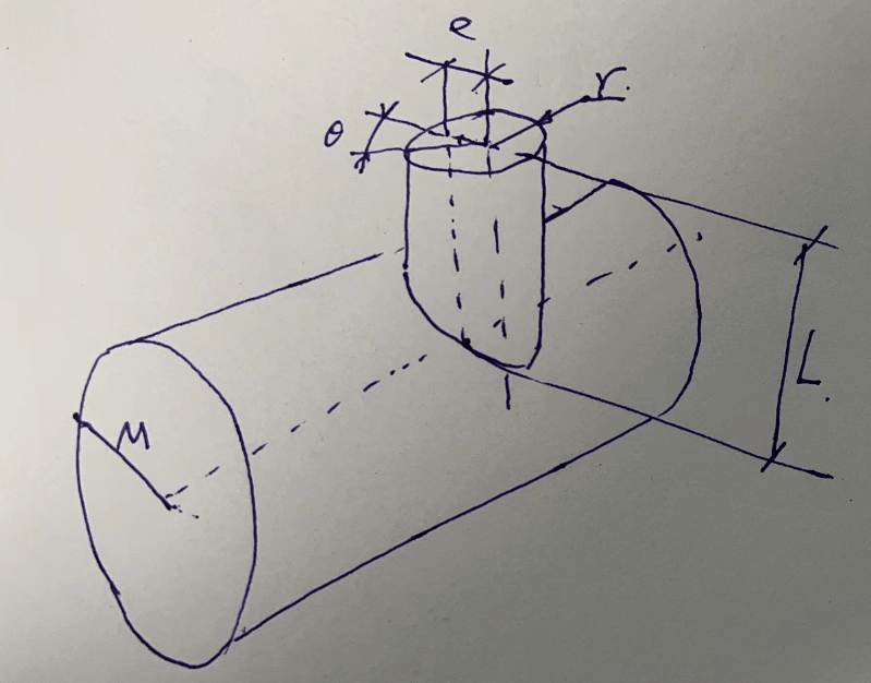

calculation of SRN nozzle forging weight 2

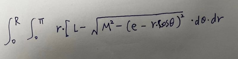

So in theory you should be able to solve analytically using calculus (set up a double integral using polar coordinates to calculate the volume of each section then multiply by the material density). But I expect that solving this would actually be quite difficult, especially for the "Q-lip" portion (the saddle-shaped part of forging that gets butt-welded to the vessel).
I would suggest that you build a 3D model the forging and to determine the volume. TEMA standards provide weight densities of most of the commonly used alloys. Barring that, you could always ask your supplier to provide the estimated weight.

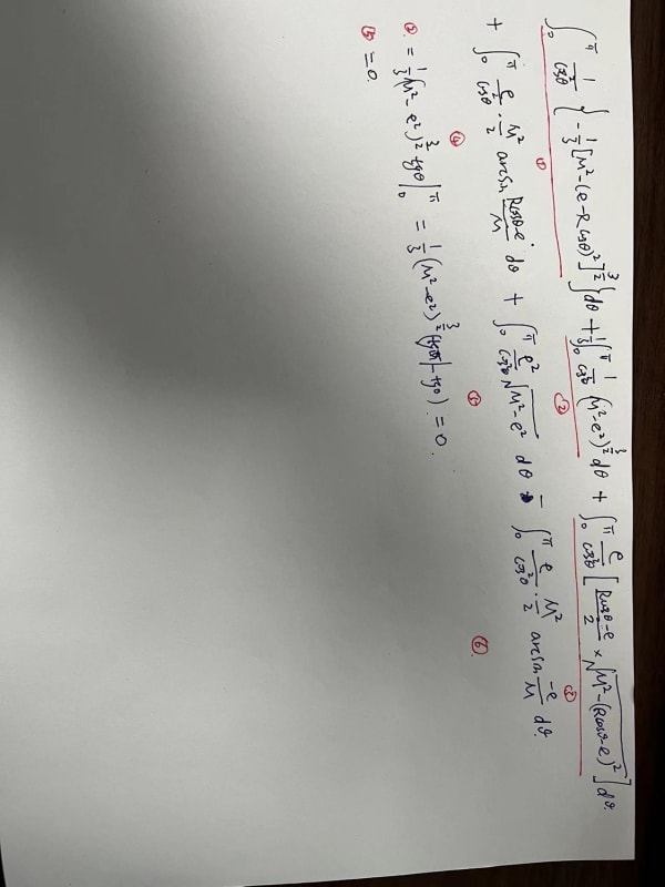

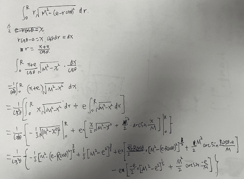

Thank you Mr.Christine74 for your valuable information. Is there any weight software or manual calculation for irregular shape elements?
