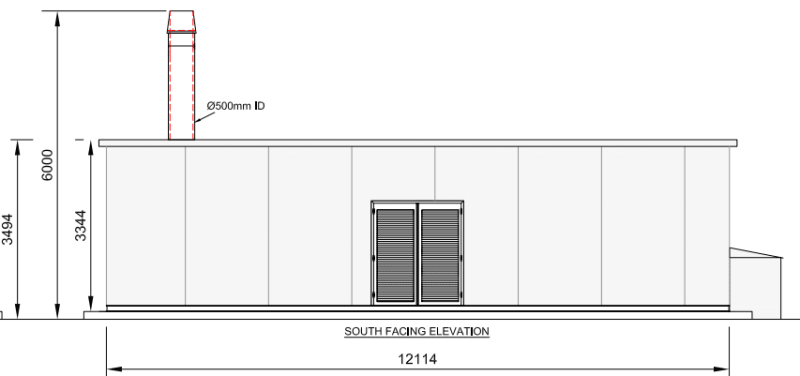

I work for a company that designs and produces pre-fabricated plant rooms. So this is what I mean by a cabin. The lifeline anchor is something the fabrication shop has sent up for calculations and design to be done.
A typical example of a cabin is below.
Another image of the concept is seen below
Motorcity, yes there should be more bracing around the base. This just wasn't sketched in
There's a lot of good info which has been given for me to go through, but human909 I have to agree with you. I'm not a structural engineer and my gut feeling when this came to me was "this needs to go out to a structural engineer to access, or purchase from fall prevention specialists".
