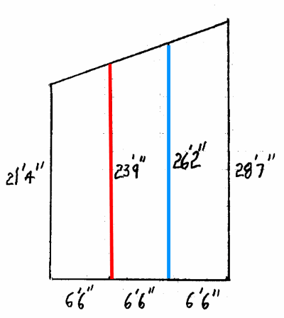

I have 3 precast slabs for a project. They vary in length from 28'-7" down to 21'-4". Obviously the 28' span will deflect the most. I calculate the DL only deflection, and its not horrible, only about 1/2" due to dl. When I add the LL to it, obviously it changes my Icr, and the deflection zooms up. I am trying to have them cast with a camber, but the range of spans will make that hard. I was thinking just camber the first slab, and then the other 2 smaller spans let them be. With a 1/2" camber in the first, I would get the first and second to match up, but the 3rd will be the problem, it will still be less deflection. Plus, I doubt these will ever see the full LL, thus that deflection not ever be seen.
Thoughts on how to handle this?

Retired13, these are 6'-6" precast planks, with a varying length. Sort of trapazoidal. Delfection is met, but the longer one will deflect more, and thus a lip between the pieces.

Is this the plan view, with supports at the ends of each slab?
Differential deflection between slabs may not be a big a concern as assumed. Note that where the slabs adjoin (shown in red and blue) the span on each slab is exactly the same. Look into this.
[idea]
Yeah, missed that part - zero differential at joints for rigid bodies.
Yes, that makes sense. For the first piece,(long side)28'-7" I am at L/187 on the long side, and L/252 at the short side (first joint). I think using a L/220 total deflection number is safe, like retired13 said its unlikely that will ever happen. Im using live load 100psf, its a outdoor walkway.
