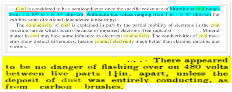

See below the following excerpt from various sources:
For LV and indoor in dry conditions, coal have minimum impact on flashover since the coal may be considered as insulator since the high resistivity.
For outdoor installation in HV substation environment in presence of moisture reduce significant the resistivity and could be cause of flashover as indicate in the enclosed excerpt.
