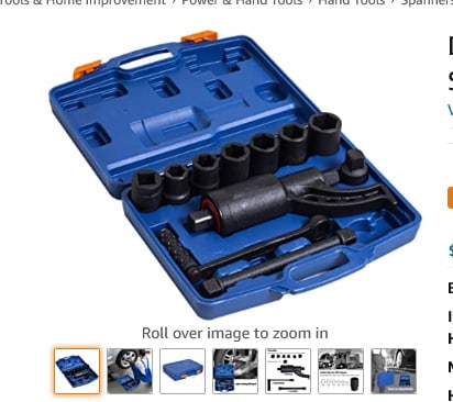

You may be able to adapt one of these and have all the torque you may ever need, now and into the future.
$84.99 at Amazon
Link
