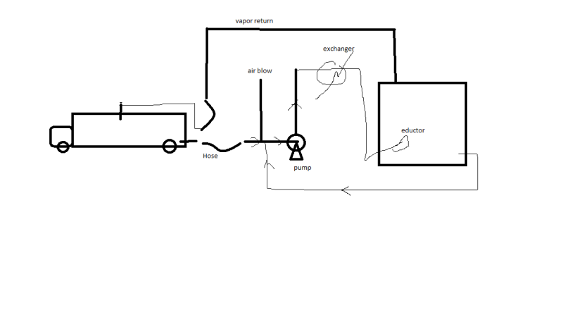

Hi folks,
We have a very hazardous chemical for bulk handling. At the end of the unloading (from the truck to the storage tank), the hose still has some chemical in it. We have difficulties to purge the hose to a safe place. (not able to purge to the tank for certain reasons). We then turn the head to the empty truck: can we purge the residual chemical to the truck via the vapor line on the truck top? Any comments?

Hi all, see attached picture, hopefully I make it reasonable.
The liquid needs constant temperature control, so the unloading pump is also used as circulation pump. We connect the hose to the truck liquid port and vapor hose to the vapor return port.
At the end of the unloading, the pump will not be able to suck completely dry the hose (it is a centrifugal pump). Therefore, the hose still has some liquid in it. We don't like the liquid stay in the hose. So would like to connect the hose to the vapor port of the truck and use the air blow to push the liquid in the hose back to the truck. [URL unfurl="true"]https://res.cloudinary.com/engineering-com/image/upload/v1631805434/tips/New_Bitmap_Image_2_nf23ia.bmp[/url]
I doubt the sketch represents elevations too accurately. Is the pump in a flooded suction or a suction lift situation (when the truck just runs dry)?

It's a self priming centrifugal pump and is about 1 ft elevation below the truck. However, it just can't completely strip the hose and the unloading line.
Sounds like it's loosing prime when the head gets so low. Is the liquid at or near it's normal boiling point, or has some dissolved gases in it?

It is pumping liquid with properties close to water.
If the tank is already vented then you have nearly 15 psi / 1bar to force liquid up. If that's not enough then how will adding more pressure help?
Could the vapor return line be too small, allowing some vacuum to build in the tanker and some pressure to build in the tank? That could explain the issue.
If this has been developing/getting worse over time, can the vapor return line be plugging?

You can use a small pump of a different style to remove residual fluid from the lowest point at the hose. An air operated double-diaphragm pump (AODD) is very well suited to this type of use.
Using compressed air to blow liquid uphill into a truck involves a number of well-known serious hazards.
