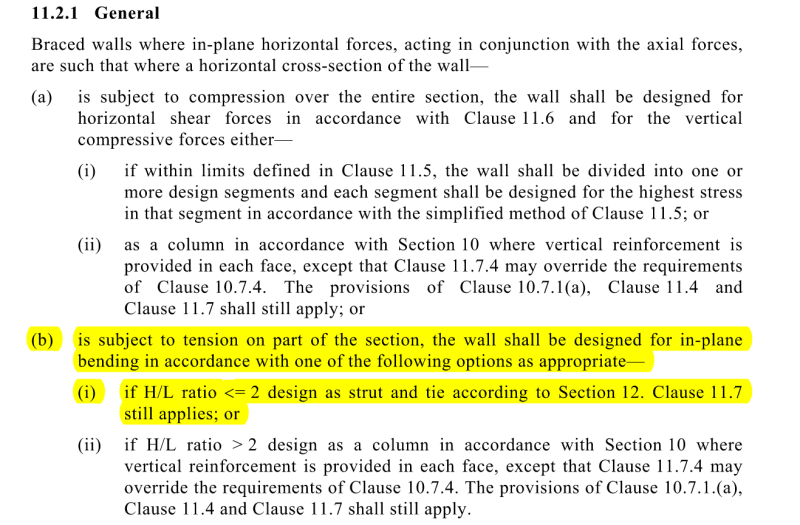

Having tension on the 150mm wall does not automatically mean you have to put two layers of reo. There is a couple of conditions you need to satisfy to avoid two layers of reo.
1. H/L < 2
this is possible for your case 2.7m high / 2m long = 1.35) Cl. 11.2.1(b)(i) states you use strut-tie to design this wall
2. Tensile stress is not greater than f'ctf, slenderness ratio < 20, ht <20m, and other parts of Cl 11.7.3. see image below
I don't think this is satisfied, right? It would require an inflection point distance of less than 85 cm.
I believe that 'H' here is the total height of the continuous wall not just one story.
This is the tricky part. Unless the whole structure model is analysed with no ductility assumed, the tensile stress cannot be used to verify this clause. But then you have to adjust your model to non ductile, which will fail for sure so you end up going back to the ductile design, which means this clause doesn't meet the condition.
Slenderness ratio looks okay to me as the unsupported height of wall is less than 3m.
